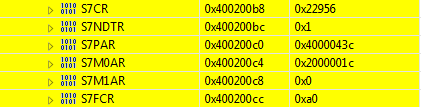

Hi all,
To start with:
Board: STM32H743ZI Nucleo
IDE: Attolic TrueSTUDIO for STM32 9.0.0
HAL version: STM32Cube_FW_H7_V1.2.0
I'm trying to trigger a DMA transfer on DMA1_Stream7 using TIMER 3 CC3. I want to trigger a transfer from a variable into the CCR for TIM3 channel 3.
I can initial the DMA stream to the configuration I think it should be in but as soon as the stream is enabled I get a transfer error and I can't work out what the problem is.
Any help would be great.
Thanks
Below is a screenshot of DMA1, stream 7 register values.
Below is my DMA stream initialisation code:

HAL_DMA_Init(htim->hdma[TIM_DMA_ID_CC3]);}UPDATE: SOLVED
As JW pointed out, the memory address of the variable I was trying to transfer was in TCM memory, which DMA1 and DMA2 do not have access to. After adding __attribute__((section(''.sram_d2'')) to the definition of the variable, it was placed into SRAM in domain 2 (address 0x30000000), this solved the problem (YAY).

‎2018-04-09 12:08 PM
The DTCM-RAM is available only to the processor and MDMA. Use other RAM (preferrably one of those in the D2 domain).
