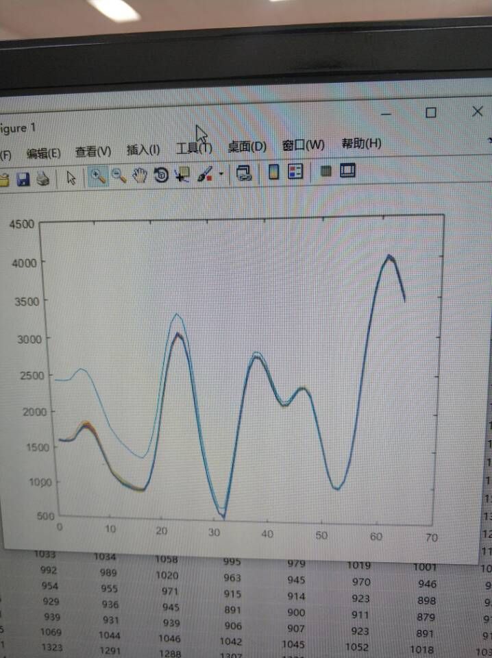

STM32H743 ADC sample x steps and each step sample y points,but the datas of first step are diffeternt from other steps
LH S
The ADC is trigggered by TIM,the sampling rate is 2M and TIM period is also 2M.I want to sample X steps, and each step samples Y points so that I could get wave figure with these data. However,I found the question that described as my question title.The wave figure is as shown in next figure.The one that sticks out is the first step with 64 points.It is so different with others but its tendency is the same as others. Next I list my code that initialize ADC.
