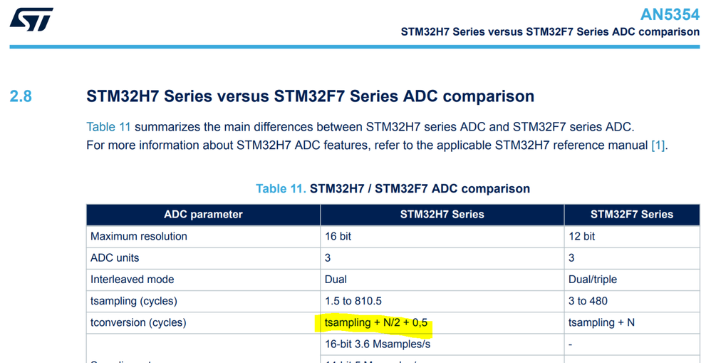

ADCs are independent. Conversion time is listed in the reference manual (I think) as well as here:
https://www.st.com/resource/en/application_note/dm00628458-getting-started-with-the-stm32h7-series-mcu-16bit-adc-stmicroelectronics.pdf
For 8.5sec sampling at 16 bits, conversion takes 8.5 + 16/2 + 0.5 = 17 cycles.
At 7MHz, that's 2.42 us.
