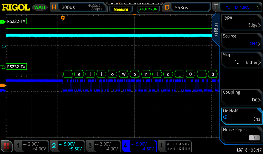

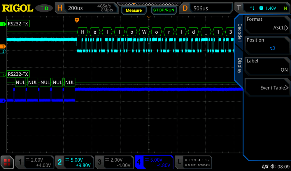

Hello Pavel, thanks for the answer. Attached some screen shots from the oscilloscope where I use a larger buffer and send the data roundrip from UART2 to UART9 and back from UART9 to UART2. There are no noises as I can see.

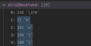

0693W00000SwDQ0QAN.png0693W00000SwDQ5QAN.pngThis is the receive buffer now with the first byte = 248d.
0693W00000SwDQFQA3.pngThis byte is only received with USART2 and not seen on HW. Could this also be a problem in the HAL?
You show two TX lines (UART2 and 9?). Look at the RX line in the moment of enabling the UART.

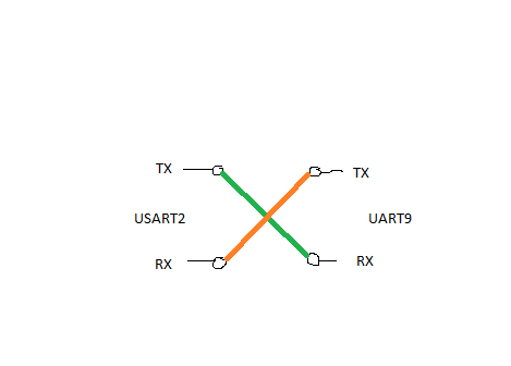

0693W00000SwJrgQAF.pngThe lines are connected as shown in the picture above. The HAL_UART_Receive_IT function is called long after initialization. Until receive, the signal level does not change at both pins. I will try to initialize with pulled up RX on USART2.
