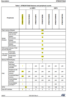

The idea to execute codeparts from RAM I had too. That's the "BootROM support" of AN5188, in opposite to the "Execute in place (XiP) support", right?
> But H730 has large RAM.
What "large" RAM do You mean? ;) This is the information I have from the Datasheet:
With this the code will probably not fit into memory, not even with all memory summed up - just an estimation. We plan several UART-based protocols, and several Ethernet-based protocols. Especially the latter I see producing quite a large code. Any opposite estimations?
So, I end up with quite some software-side effort to manage the memory and the shoveling? It's no blocker, but I must take that into conideration.

I made a small test bringung up ethernet (from a rust example), and it went already above 128 KiB. That's where I took my assumption, that the whole thing will not fit. But thanks for the "counter estimation", that You got stuff running at 350 KiB. Still, also this already would take some efforts to get the code from the external flash into several RAM banks. (I haven't dealt with this yet.)
More than 128 KB ))
