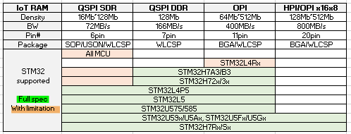

2023-02-08 6:54 AM
Ok that's seems good to move to OPI.
You have a wide range of option from 64Mb up to 512Mb 1.8V or 3V
OPI equivalent product of the QSPI product you have tested: APS6408L-OBM-BA
For reference and proto:
Alex

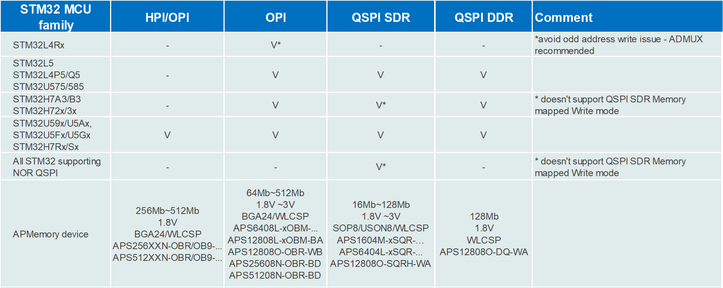

I have a question regarding the AP memory, APS6408L, I am trying to interface it with STM32U585 (actually using a B-U585I-IOT02A dev kit). I am using memory mapped mode for both read and write.
According to the datasheet, page size is 1Kb and I saw this additional information in the datasheet,
"7.2 Burst Type & Length
Read and write operations are default Hybrid Wrap 32 mode. Other burst lengths of 16, 32, 64 or 1K bytes in
standard or Hybrid wrap modes are register configurable(see Table 20). The device also includes command for
Linear Bursting. Bursts can start on any even address. Write burst length has a minimum of 2 bytes. Read has no
minimum length. Both write and read have no restriction on maximum burst length as long as tCEM is met."
Does this mean, it is possible to write datalength of more than 1Kb at a time in memory-mapped mode? Does the page size restrict the maximum size of data that can be written at once? I am using memcpy command to copy the data.
Thanks in advance.
Rikesh

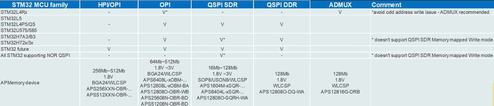

2024-04-17 10:30 AM
Just updating the STM32 - IoT RAM (QSPI, Octal and Hexa RAM) support overview
2024-04-17 11:22 AM
Updated AP Memory IoT RAM (QSPI, OPI & HPI PSRAM) overview with latest STM32 MCU
