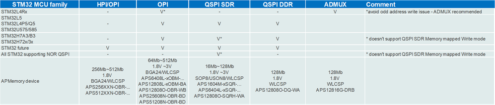

We have studied this case and concluded it's not possible to get full functionnality of STM32H7A (also H72x/3x) with QSPI SDR. But it works well with QSPI DDR (7pins, 128Mb in WLCSP) and OPI (11pins, 64Mb~512Mb BGA24/WLCSP). Other STM32 works well also with all device, including QSPI SDR (6 pins, 16Mb~128Mb, SOP8/USON/WLCSP).
Regards
Alex

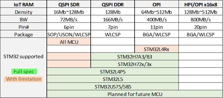

2022-03-30 3:01 PM
Here is an overview of STM32/APMemory IoT RAM device supported
covering HPI, OPI, QSPI SDR, QSPI SDR per STM32 family
Hope this help
For proto: https://www2.mouser.com/c/?m=AP%20Memory%20Technology
2022-03-30 3:17 PM
another way to show the data
