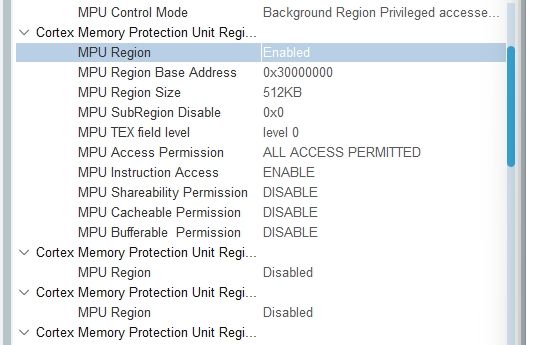

[STM32H7] When I set the MPU at the address 0x30000000,Program entry HardFault
Passerby
The configuration of Cubemx is as follows
The configured address is the address of SRAM1-3,given this configuration, why does "Strongly ordered memory" cause a HardFault
Thanks.

Hello,@Sarra.S
But it works when I set it to "TEX = 1   C = 0  B = 0  S = 0", shareability is disable,Why?
When I set it to  "TEX = 0   C = 0  B = 0  S = 1",it is cannot work。
Thanks.

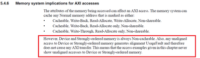

Are you doing an Unaligned access to that memory region?
See: https://www.keil.com/support/docs/3777%20%20.htm
From ARM CM7 TRM:
Hello @mƎALLEm
I use CubeMX ETH LWIP(LAN8742)  default settings ,does this result in unaligned access?The MPU is as I configured it.
I use cubemx 6.8.0 ,HAL FW_H7 v1.11.1
Thanks!
I don't know about LWIP, but you can check if you faced an unaligned access in your application by reading SCB_CFSR register:
If SCB_CFSR = 0x01000000 -> you have an unaligned access.
For your reference: https://developer.arm.com/documentation/dui0646/c/Cortex-M7-Peripherals/System-control-block/Configurable-Fault-Status-Register?lang=en#Cihgbdbi

Hello @mƎALLEm
Thank you for your reply 。
I read the "SCB->CFSR" register, and when set to "device" or "strongy-ordered", it is indeed 0x0100 0000, which indicates an "Unaligned access UsageFault" error according to the register interpretation!
