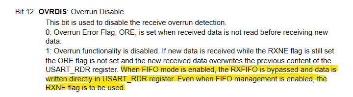

Dear @Pavel A.​
An additional check : could you try to remove the Overrun feature disabling (keeping Overrun function as usual) for a check. I'm afraid this could be interacting with the FIFO mode: See following excerpt from Reference Manual about OVERDIS bit :
 0693W00000Dq5QyQAJ.pngWhat might happen is that OVERDIS is set, only a RXNE interrupt could be triggered but as FIFO is enabled, only RXFTIE is enabled ...

Dear @Pavel A.​
Dear Guenael,
This was it! Without overrun disable the FIFO threshold interrupt works fine.
I've developed a habit to always disable overrun detection because it somehow interfered with polling HAL RX function.
Will re-test this with the latest H7 HAL library.
Thank you a lot!
-- Pavel

I spent so much time trying to figure out why RXFTIE wasn't working and I was convinced there was some device errata that was not documented. There should be a note in the reference manual for CR3 bit 23, that in order to use RXFTIE that OVERRUN needs to be enabled. The note is in the wrong place.
