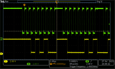

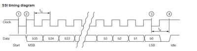

Hello, in my project I need to read an encoder that clocks out data with clock burst. For this I decided to use UART with clock generation and DMA. (I also mixed up RX from one UART to another , but this is not a problem if request happens at the same time which it does)
I have multiple DMA channels running, so I would like to think I set up everything correctly. In order to receive, I have to make fake TX bursts, since clocks are not generated only in RX mode.
For this I have 4 streams ( 3 4 5 6 ). And TX works great, I get clock burst at CK pin of USART peripheral (both of them at the same time) BUt I get TE DMA errors at receiving and, and I Get no data, and Can’t understand the reason why. I am also using correct memory for that DMA with memory protection unit. I have no problem in other DMA channels using same memory location. (0x2400000 location of AXI RAM)
And this is what I get :
Clock is nice, and I get data from the encoder, no problem. Gaps in clock are allowed as long as they are below 15us
And here is my code (DMA2 clock is enabled elsewhere, also USART2/6 is running at 137.5MHz) and both USART2 TX and USART6 TX are forking, TC are triggering, and TE is 0 for this stream (to generate clock burst)
