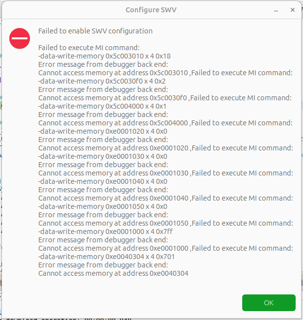

Explorer
Oct 4, 2024 9:57 AM UTC
Hi, did you get a solution to this? I'm having the same problem.
SWV works perfectly with HSI and HSE directly, but not through the PLL. Trying to start the Trace errors out with the following error.

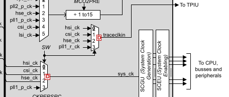

ping_pongAuthorBest answer
Oct 8, 2024 9:43 PM UTC
My solution was pretty simple. The output from DIVR1 must match the SYSCLOCK. If not, it breaks. Doesn't matter what combination of divisors and prescalers are used, as long as DIVR1 matches the SYSCLOCK.
As a general solution, ensure that the clock source for the SWV is enabled, and that it matches the PLL (or other clock as required by the datasheet.)

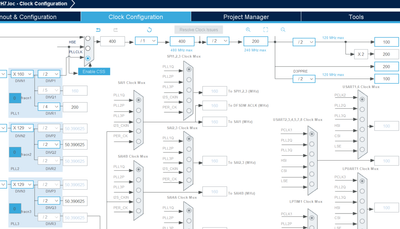

  • CM7 configured for 400 MHz using PLL, i.e. max possible frequency using switched-mode power supply (SMPS).
  • PLL1R clock set to 200 MHz - this is important
  • Debug mode set in MX to "Asynchronous Trace SW"
  • Added _write() function to my code as per normal instructions.
Working clock config as below:
After editing the Debugger config in CubeIDE to enable SWV and setting the CPU clock speed there (alongside SWV settings) to 400 MHz, I found that printf() produces no output and variables added to the SWV Data Trace Timeline Graphs are NOT logged.
After lots of experiments I found that if I set the CPU clock in the debugger settings for SWV to 64 MHz, then I see some garbled data coming out printf() on the SWV ITM Data Console view, and occasionally some invalid data variable trace values - clearly there's something wrong in that setup.
When I changed my core clock in MX to 200 MHz I noticed a warning from MX that the PLL1R clock was too high at 400 MHz, so I changed its divisor so that PLL1R clock is 200 MHz, then with the Cube IDE debugger config now set to 64 MHz core clock setting I have printf and data trace logging working perfectly. This is strange because standard advice is that SWV's configured CPU freq is supposed to match the true CPU clock.

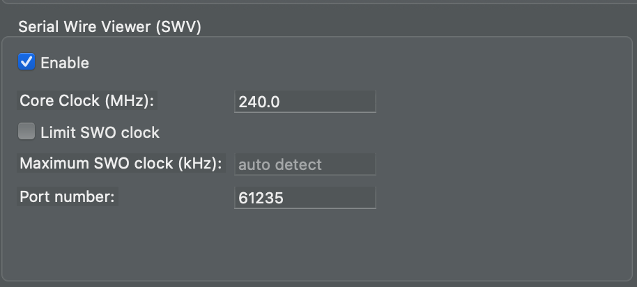

Senior
Oct 15, 2025 9:09 AM UTC
You can have PLL1R different from SYSCLK but the Core Clock settings must be the PLL1R value
My SYSCKL is 480 MHz and my PLL1R is 240 MHz
