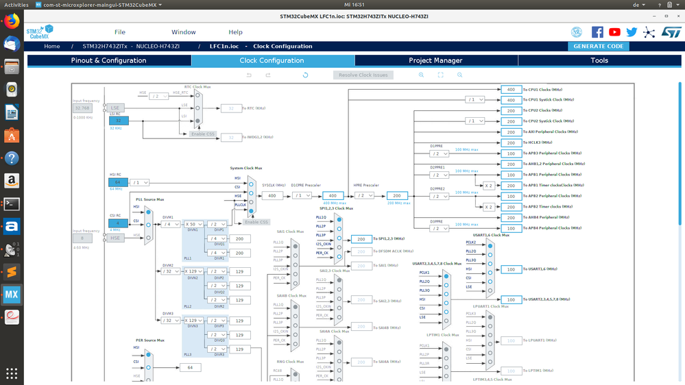

‎2019-03-13 6:12 AM
Hello @JLima​ ,
Another difference between SPI1 and SPI6 is that SPI1 is mapped on APB2 and SPI6 on APB4.
Are they configured to use same frequency?
-Amel
‎2019-03-13 8:55 AM
Hello @Amel NASRI​ ,
Thanks for the reply. Seems like they are. I am attaching a picture from the clocks. Any other idea? Is there any bug related with the Bus bridges that we have to workaround that is not included in the code generated by CubeMX? The SPI bugs seem to be already addressed by the generated code from CubeMX.
