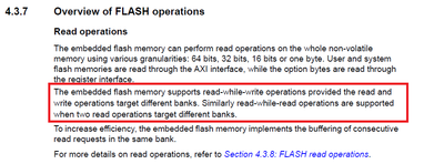

I found this thread, confirming my suspicions:
Although it makes absolutely sense, but where can I find this info in the H73x RM0468 ?

Read accesses to the active Flash array will stall the processor, basically it will stuff wait-states to hold off the MCU until the array has finished.
Can be avoided by executing from RAM, or from an entirely different bank of FLASH.
Must avoid interupts/vectors pointing into FLASH, and any call tree for any function you call/use.
Not sure this is explicitly discussed in any given manual, assumed it was common knowledge for most every NOR Flash for the last several decades. You basically have to spin wait on the FLASH's status. On the STM32 the safety fence is stalling the MCU, which only kicks in when you try to peer around the curtain.

Maybe you need to relocate the vector table and the code in the RAM while doing this operation.
There is no read-while-write operation support on H723 like in H743:
H743 (RM0433) :
