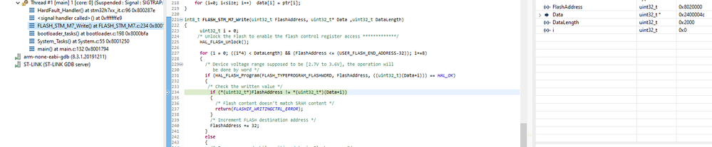

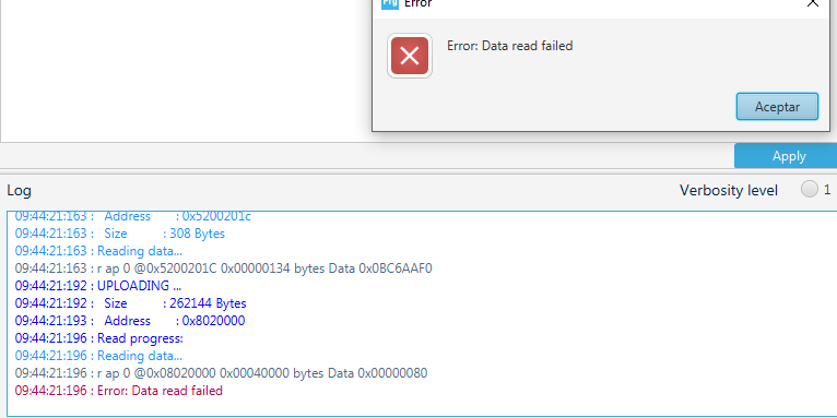

I am trying to build an iap that reads a .bin file from a uSD card and loads it into the flash memory, but something is happening with the erase function. If i run this bootloader and the flash is empty everything works just fine. However, if the flash is not empty, the HAL_FLASHEx_Erase returns HAL_OK but then, when trying to write it crashes. If i stop the program just before the write function and go to the STM32CubeProgrammer in order to watch if the flash has been erased, if returns a "Error: Data read failed" message".

What sectors are you erasing? Is a watchdog event happening? Does it work correctly if you step through the code, and if not, where and how does it fail?
I am really sorry for the late answer, i could not try it anymore until now. I am erasing the whole memory starting from the address 0x08020000 and it is not happening a watchdog event.
The erase function returns HAL_OK but then the write function crashes when trying to write something, like it would happen if the memory had not been erased before. If i step through the code the result is the same...

Maybe i have missed something but in the end it seems that the problem was in the flash initialization. I had this:
	HAL_FLASH_Unlock();
	  __HAL_FLASH_CLEAR_FLAG(FLASH_FLAG_EOP | FLASH_FLAG_OPERR | FLASH_FLAG_WRPERR | FLASH_FLAG_PGSERR | FLASH_FLAG_WRPERR);
	HAL_FLASH_Lock();
and then i commented the "HAL_FLASH_Unlock();" and "HAL_FLASH_Lock();" lines and everything started to work as it should.
Piranha
Chief II
Take a note that by default FLASH is configured as a write-through memory. Because of that, after erase completes one typically must do cache invalidation on the erased sectors. If that is not done, cache can contain old data.
