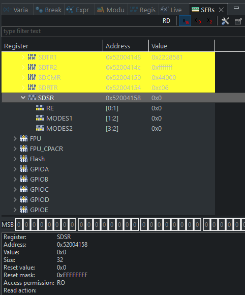

The same question for STM32H725 (RM0468). But in the reference for STM32F7 this bit is described:
Bit 5 BUSY: Busy status
This bit defines the status of the SDRAM controller after a Command Mode request
0: SDRAM Controller is ready to accept a new request
1; SDRAM Controller is not ready to accept a new request
It seems there are similar errors in some documents, but this bit is not precent in IDE
0693W00000NpHxnQAF.pngSo so, where is comment from ST?
