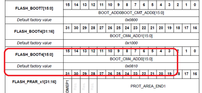

As you said, I only changed the CM4 .ld file. The code 0x081e0000 is loaded to this address. I can verify this with cube programer. I do not change the Option bytes. Default boot address(0x08100000 ). But still CM4 is not working.
Sorry, this is not the default option byte value for boot address and I think 'e' in 0x081E0000 came from your configuration:
From the RM. The factory value is 0x0810 while you have 0x081e.
Yes. The default address for M4 is 0x081E0000. My goal is to allocate more flash for M7. 1024 kbytes is not enough for me. I want to decrease the flash of M4 and increase the flash of M7. For this, I want to start m4 from this address 0x081E0000.
This is what I want to tell you from my first post. You don't have to manage that in option bytes just do it in the linker file.
I do what you say.M4 still not working.I did not change the options bytes.
My settings are exactly as follows.
M4 core not working.
FLASH (rx) : ORIGIN = 0x081E0000, LENGTH = 128
