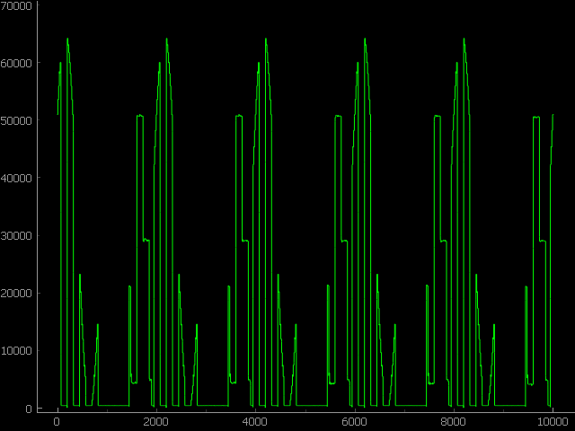

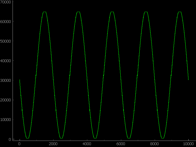

SEng.1
Hi @Community member​ :
I'm using onboard ADC and output to pc so that i can plot out the sinewave in python.
here is the graph with wave_LUT:
0693W00000DnbZmQAJ.png Here is the graph for calsine:
0693W00000DnbZrQAJ.pngAll the code exactly the same except one using lookup table and another is calculated.
I got this wave_lut table from here
As for the calsine, i follow this

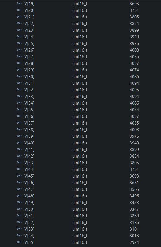

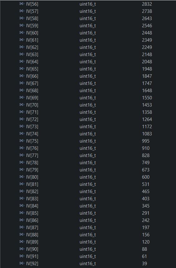

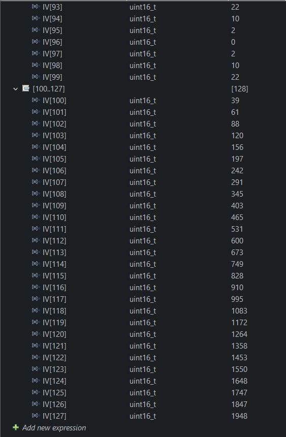

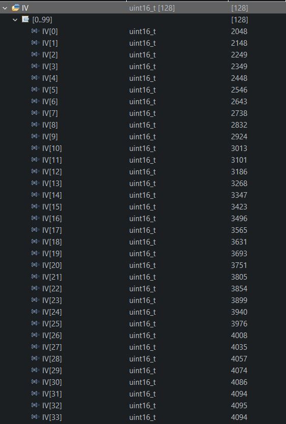

I check the IV value, they all looks normal to me.
except slight difference compare to the wave_lut table.
