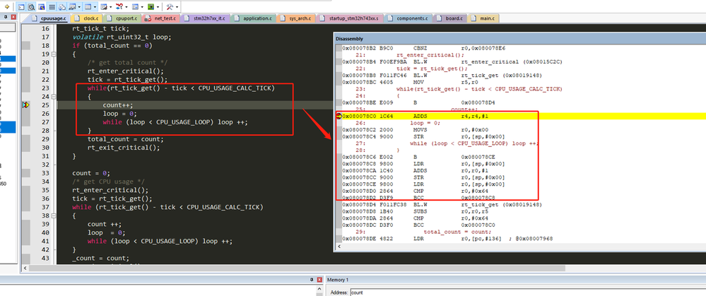

test code as below:
#include <rtthread.h>
#include <rthw.h>
#define CPU_USAGE_CALC_TICK    100
#define CPU_USAGE_LOOP        100
static rt_uint8_t  cpu_usage_major = 0, cpu_usage_minor= 0;
static rt_uint32_t total_count = 0;
 static rt_uint32_t _count = 0;
//static rt_uint32_t loop;
static void cpu_usage_idle_hook()
	rt_uint32_t count;
    rt_tick_t tick;
	volatile rt_uint32_t loop;
    if (total_count == 0)
        /* get total count */
        rt_enter_critical();
        tick = rt_tick_get();
        while(rt_tick_get() - tick < CPU_USAGE_CALC_TICK)
			count++;
            loop = 0;
            while (loop < CPU_USAGE_LOOP) loop ++;
		total_count = count;
        rt_exit_critical();
    count = 0;
    /* get CPU usage */
    while (rt_tick_get() - tick < CPU_USAGE_CALC_TICK)
        count ++;
        loop  = 0;
	_count = count;
	rt_exit_critical();
    /* calculate major and minor */
    if (count < total_count)
        count = total_count - count;
        cpu_usage_major = (count * 100) / total_count;
        cpu_usage_minor = ((count * 100) % total_count) * 100 / total_count;
    else
        //total_count = count;
        /* no CPU usage */
        cpu_usage_major = 0;
        cpu_usage_minor = 0;

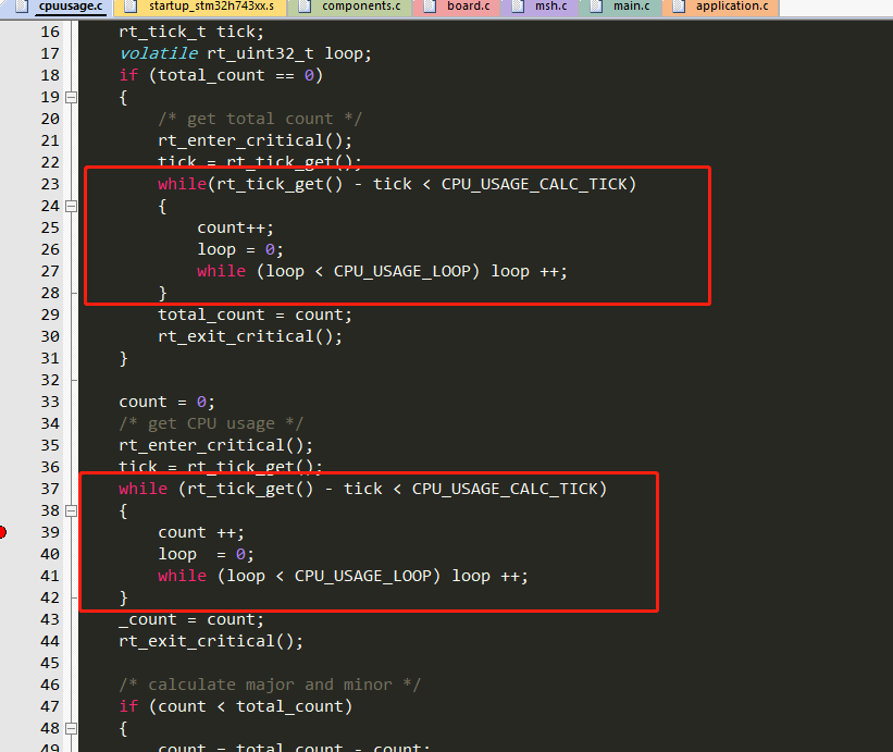

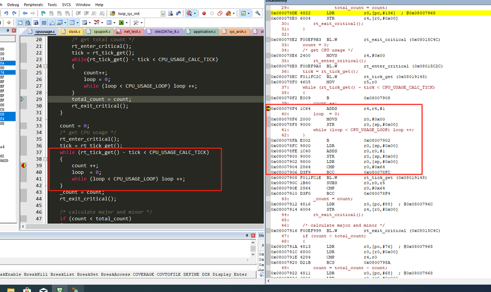

The same code runs at different speeds,the total_count  = 54580 ,However the is _count = 13633,75% reduction in CPU performance 。
The assembly code is as follows:

The above test code runs under the same clock configuration (480MHz). The _count and total_count in the test code are sometimes the same (_count ~=total_count ~=60000) and sometimes different (_count ~=13000, total_count ~=60000). When it is different, if you add several nop instructions before calculating _count, _count becomes as large as the value of total_count again. When it is abnormal, we have tested the system frequency through MCO and it is normal.
