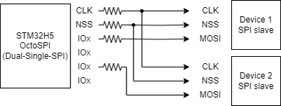

Is it possible to use STM32H5 OctoSPI interface (configured as Dual-Single-SPI) as two individual transmit-only SPI masters?
Requirements:
1. Two devices connected to MCU are identical but receive different data
2. Devices are not a memory
3. No data needs to be received by MCU
4. No simultaneous write is required (edit after first reply: Simultaneous write is required)
If such configuration is possible, how will HAL code look like?
Which of OCTOSPI_IO0, IO1, IO2, IO3 pins are can be configured as 'MOSI'?

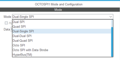

Edit: I realized 'Dual SPI' and 'Dual-Single SPI' are a different things. Changed post subject to 'Dual-Single SPI'

  • With STM32CubeMx toolchain, you are able to configure only one device. For that, I recommend you to code this behavior manually.

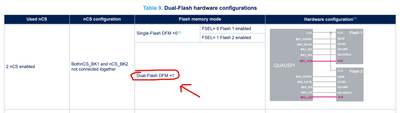

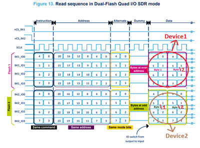

I've researched the topic a bit further and found Dual-Flash configuration in AN4760 (Figure 13 and Table 9).
I believe that Dual-Flash = (Dual-Single or Dual-Dual or Dual-Quad) SPI that can be selected in CubeMX.
Based on this forum post you've previously anwsered I have a following question:
Question2: What if we wanted to write to both devices simultaneously using Dual-Flash (Dual-Single) SPI configuration? (assuming that data buffers for devices 1 & 2 were interleaved ahead of time, e.g.: [Byte1Dev1] [Byte1Dev2] [Byte2Dev1] [Byte2Dev2] )
Question3: Is it possible to mirror SPI CLK signal on additional pin to eliminate star connection (trace split in two) on PCB?
Q3: no, it is not possible to bring out the same SCK signal also on a different pin (just one or the other). I do not know what would happen if you configure two different pins with the "same" ALT to provide the same SCK output (interesting trial). I assume, MCU will take the last pin you have configured via ALT as QSPI SCK out.
You could use QSPI in order to send - in parallel - to two different chips. But just Tx (only MOSI used), Rx is not possible.
Based on your schematics: you would run QSPI in 4-lane-mode (real QSPI): on DIOx (e.g. bit 0) goes to one chip, the other DIOx (e.g. bit 2) goes to another chip. Both chips are selected at the same time (via NSS).
But: there is just one register for the CMD, ADDR, ALT, DATA sent via QSPI. You had to place the bits for each chip on the right bit position in the data word sent. You do not have two separate registers for each chip, just one for both and you have to merge the different bits into one register word. (effort, but possible).
If you do not need to write both chips really in parallel - you can use TWO separate NSS signals: select one chip, send, select the other chip and send. NSS can be also a regular GPIO signal (and use SW control for NSS).
