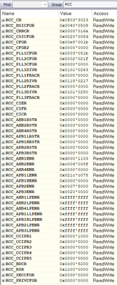

So print out the clocking the part thinks it has.
Unpack the RCC registers
Export the internal clock via PA8 / MCO

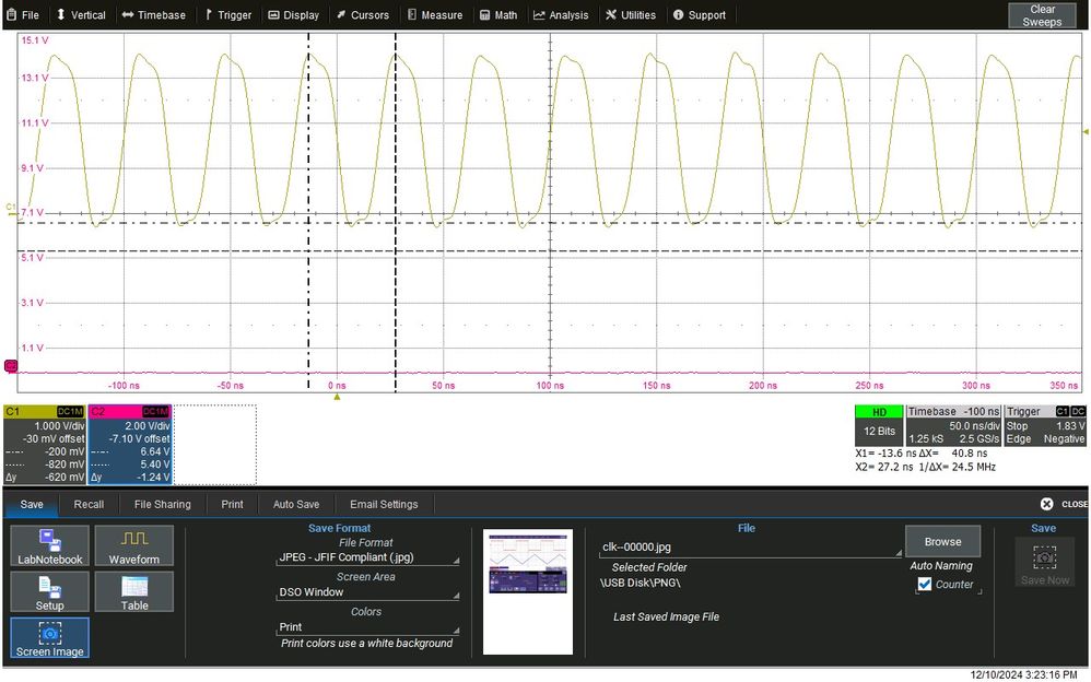

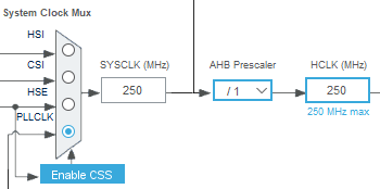

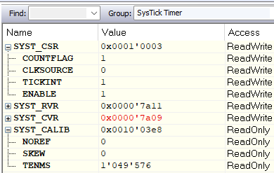

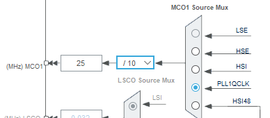

‎2024-12-09 11:31 PM
Here are registers:
And PA8:
clocks
And main clock selection:
‎2024-12-10 2:03 PM
0x7A11 * 8 ~ 249992 seems Ok
