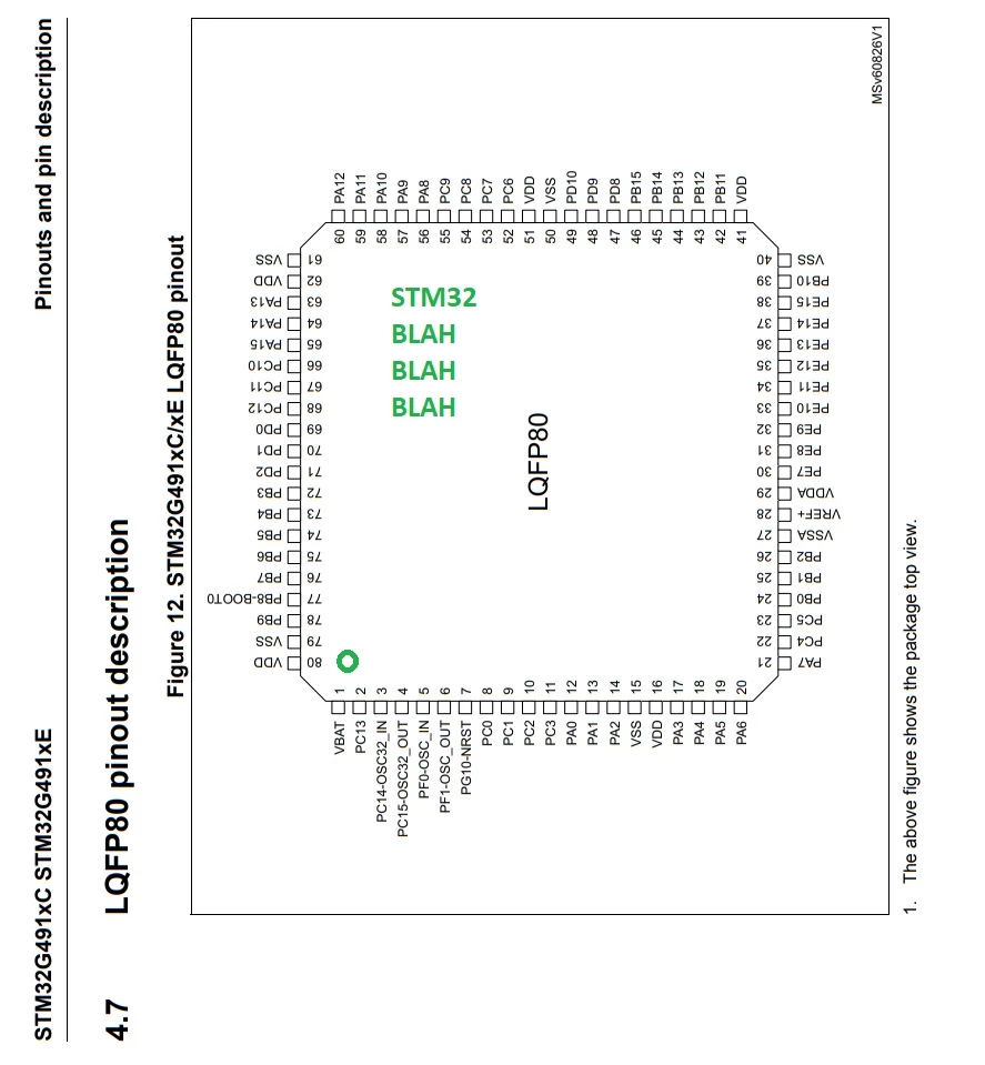

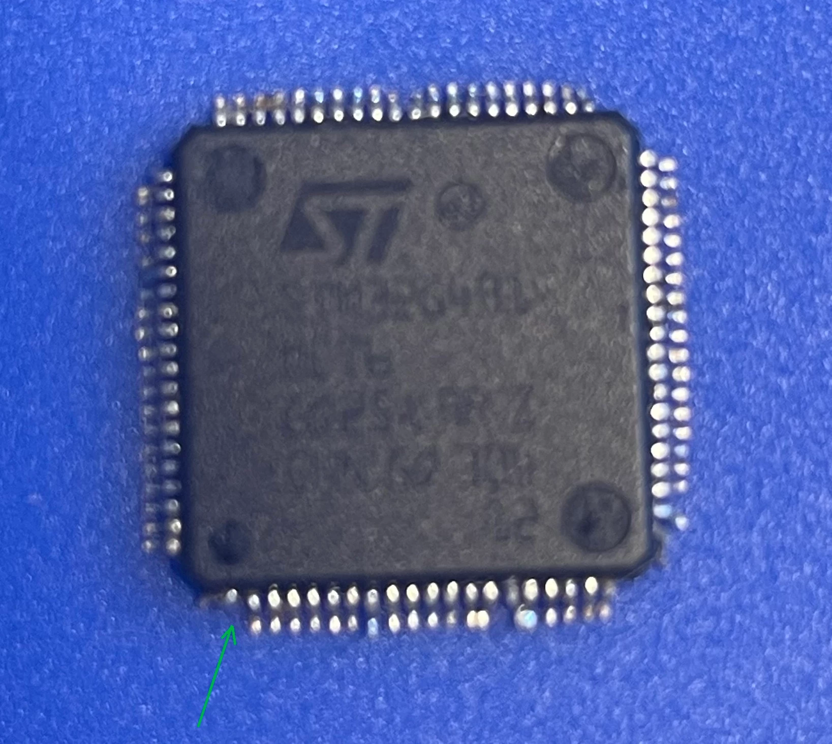

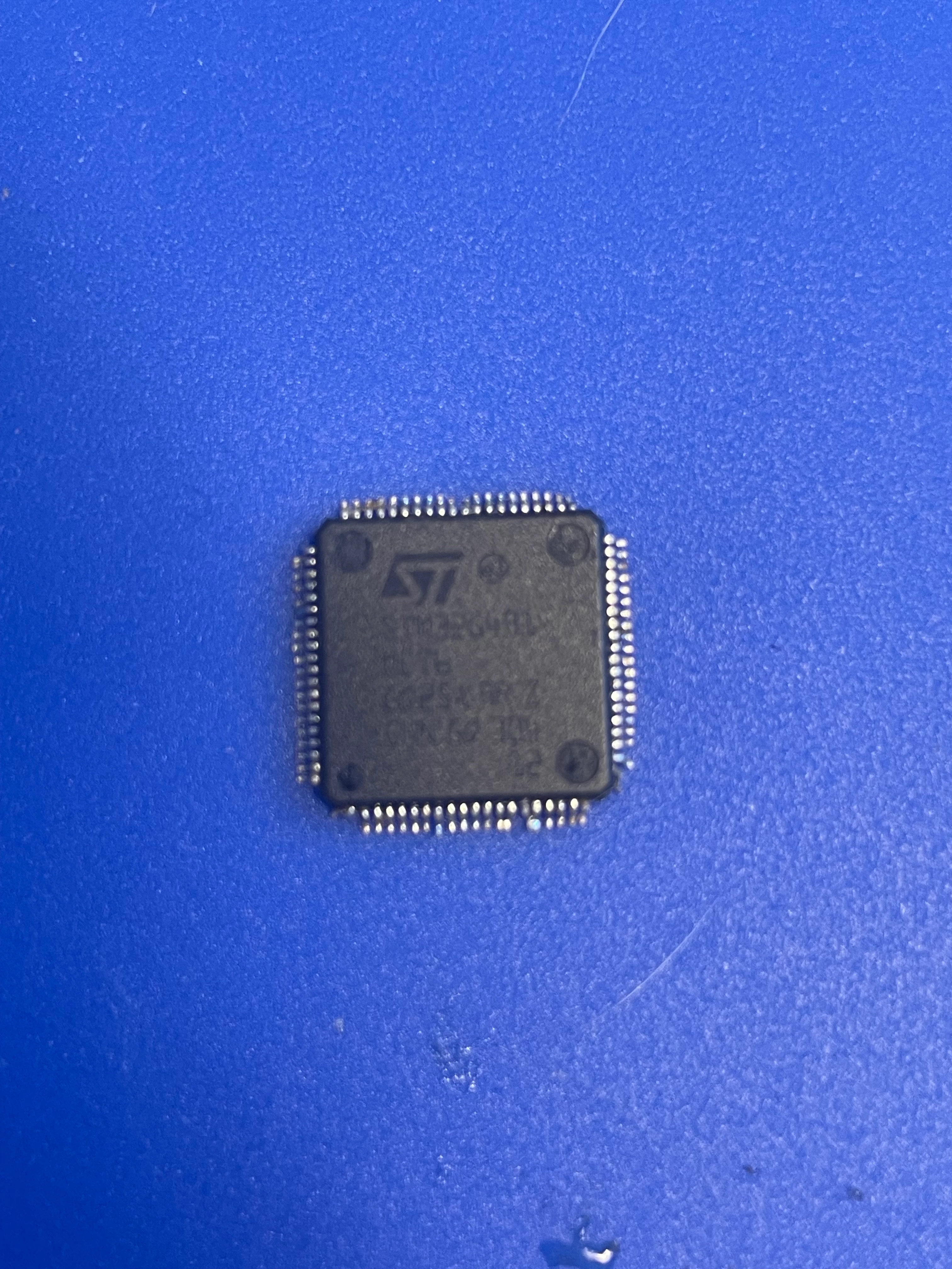

Hey, i
got this STM32G491MET6
The datasheet does not really help here to identify pin 1, since there are 4 markings to see. Anyone has a clue on this? In the previous revision of this datasheet, Pin 1 is bottom left . Already burnt 2 mcus because of this...

Smaller circle, bottom left. The others are molding / ejector related.
ST prints the text in top-to-bottom, left-to-right western form. Held in a readable fashion the Pin 1 designation is down and to the left.
Tesla DeLorean
Guru
May 20, 2024
My expectation is that legitimate parts will have a common VSS bonding, which you could continuity check to confirm orientation expectations.
Could perhaps look for other boards, orientation, where VCC and GND enter, HSE placed, SWDIO/SWCLK and VCAPs (where used)

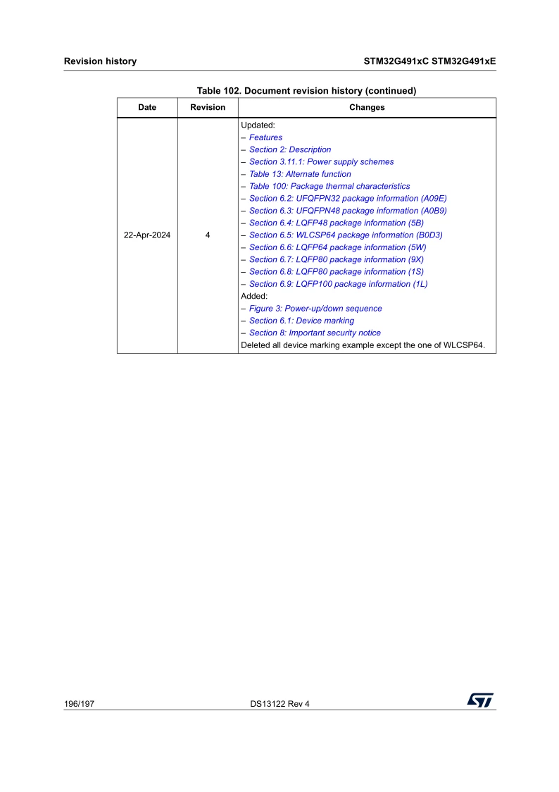

waclawek.jan
May 20, 2024
This appears to be a regression in rev4 of the DS:
@Imen.D, can you please have a look at this? Thanks.
May 23, 2024

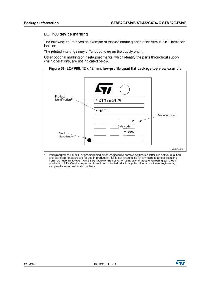

Hi @waclawek.jan,
All device markings are being removed from the Datasheet and are being moved to the Technical note: Reference device marking schematics for STM32 microcontrollers and microprocessors.

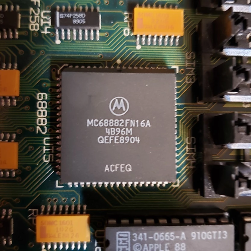

On most ICs, the bottom row of the label contains the first pin.
Tesla DeLorean
Guru
May 23, 2024
Which is great advice until it's not..
You should have a conversation with my pick-n-place guy some day..
Muhammed Güler
Senior III
May 23, 2024
I've never encountered an IC labeled like this before. Until you showed me this picture, I believed there was a standard for IC naming that I didn't know about.
