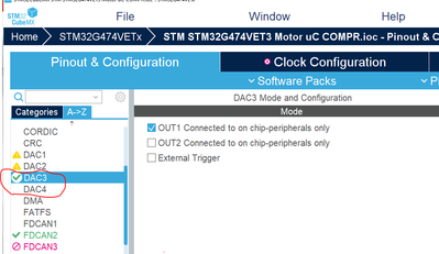

STM32G474VET3: internal DAC reference to the internal comparator configuration in CubeMx
sag

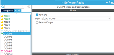

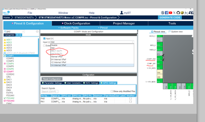

I am not able to configure internal DAC reference to the internal comparator  of STM32G474VET3
sag
Thanks Peter for this guidance.

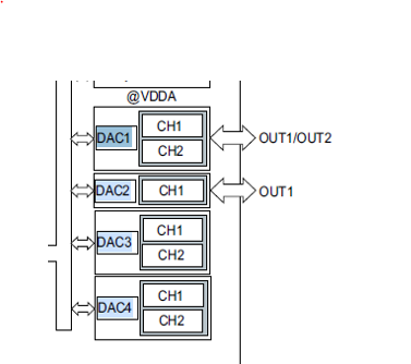

Internal DAC options are related to DAC3 channels 1 & 2 and DAC4  channel 1 & 2 Only.
So need to enable those first.
Thanks

Peter BENSCH
If you hover the mouse pointer over the greyed-out text, e.g. DAC1 OUT1, you will be shown a message explaining why it is greyed out. Specifically, it is here: "Need to have a 'DAC Out' activated [...]". So all you have to do is assign a DAC to the on-chip peripherals and you can configure the corresponding function in the COMPx.
Hope that helps?
Regards
/Peter
sag
Thanks
