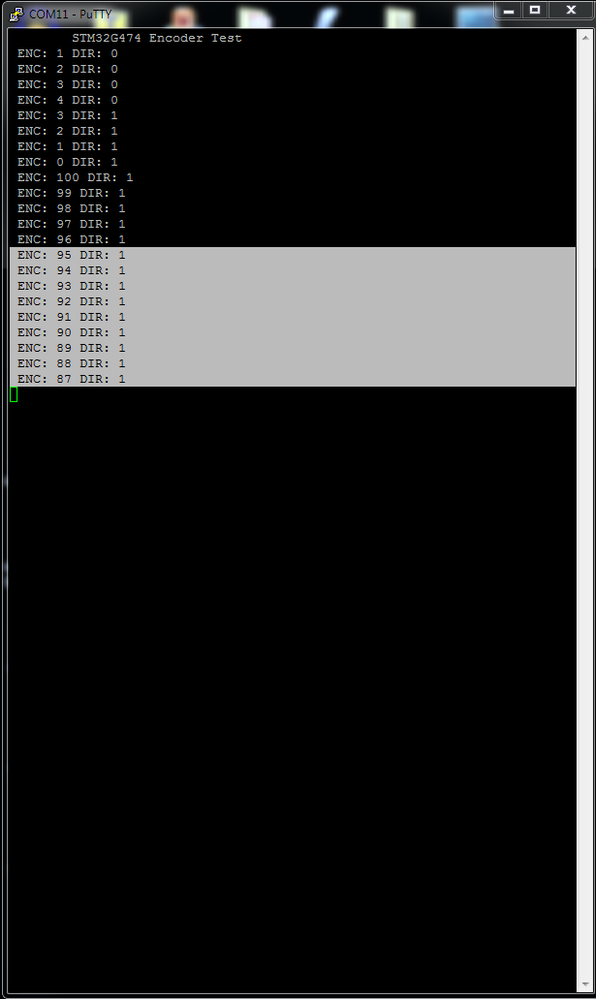

Greetings!
I have a Bourns Rotary encoder
https://www.bourns.com/docs/product-datasheets/pec11r.pdf
connected to PA11(ENCA)/TIM4_CH1 and PA12(ENCB)/TIM4_CH2.
Trying to use the encoder as a input control for user input.
This is what I am doing:
static void encoder_init(void)
	LL_GPIO_InitTypeDef		gpio;
	LL_APB1_GRP1_EnableClock(LL_APB1_GRP1_PERIPH_TIM4);
	gpio.Pin	= LL_GPIO_PIN_11 | LL_GPIO_PIN_12;	/* Enc A, Enc B */
	gpio.Mode	= LL_GPIO_MODE_ALTERNATE;		/* Alternate function */
	gpio.Speed	= LL_GPIO_SPEED_FREQ_LOW;		/* Low Speed */
	gpio.Alternate	= LL_GPIO_AF_10;			/* AF10=TIM4 */
	LL_GPIO_Init(GPIOA, &gpio);
	LL_TIM_SetPrescaler(TIM4, 0);
	LL_TIM_SetAutoReload(TIM4, 100);
	LL_TIM_SetCounterMode(TIM4, LL_TIM_COUNTERMODE_UP);
	LL_TIM_SetClockDivision(TIM4, LL_TIM_CLOCKDIVISION_DIV4);
	LL_TIM_DisableARRPreload(TIM4);
//	LL_TIM_SetEncoderMode(TIM4, LL_TIM_ENCODERMODE_X4_TI12);
	LL_TIM_SetEncoderMode(TIM4, LL_TIM_ENCODERMODE_DIRECTIONALCLOCK_X1_TI12);
	LL_TIM_IC_SetActiveInput(TIM4, LL_TIM_CHANNEL_CH1, LL_TIM_ACTIVEINPUT_DIRECTTI);
	LL_TIM_IC_SetPrescaler(TIM4, LL_TIM_CHANNEL_CH1, LL_TIM_ICPSC_DIV1);
	LL_TIM_IC_SetFilter(TIM4, LL_TIM_CHANNEL_CH1, LL_TIM_IC_FILTER_FDIV2_N8);
	LL_TIM_IC_SetPolarity(TIM4, LL_TIM_CHANNEL_CH1, LL_TIM_IC_POLARITY_RISING);
	LL_TIM_IC_SetActiveInput(TIM4, LL_TIM_CHANNEL_CH2, LL_TIM_ACTIVEINPUT_DIRECTTI);
	LL_TIM_IC_SetPrescaler(TIM4, LL_TIM_CHANNEL_CH2, LL_TIM_ICPSC_DIV1);
	LL_TIM_IC_SetFilter(TIM4, LL_TIM_CHANNEL_CH2, LL_TIM_IC_FILTER_FDIV2_N8);
	LL_TIM_IC_SetPolarity(TIM4, LL_TIM_CHANNEL_CH2, LL_TIM_IC_POLARITY_RISING);
	LL_TIM_EnableCounter(TIM4);
	LL_TIM_CC_EnableChannel(TIM4, LL_TIM_CHANNEL_CH1);
	LL_TIM_CC_EnableChannel(TIM4, LL_TIM_CHANNEL_CH2);
int main(void)
	uint32_t enc_cur = 0, enc_prev = 0;
	LL_APB2_GRP1_EnableClock(LL_APB2_GRP1_PERIPH_SYSCFG);
	LL_APB1_GRP1_EnableClock(LL_APB1_GRP1_PERIPH_PWR);
	NVIC_SetPriorityGrouping(NVIC_PRIORITYGROUP_4);
	SystemClock_Config();
	gpio_init();
	uart_init();
	encoder_init();
	printf("\tSTM32G474 Encoder Test\n");
	while (1) {
		enc_cur = LL_TIM_GetCounter(TIM4);
		if (enc_cur != enc_prev) {
			printf(" ENC: %d DIR: %d\n", enc_cur, LL_TIM_GetDirection(TIM4) >> 4);
			enc_prev = enc_cur;
On RST, I get the following results:
 ENC: 1 DIR: 0
 ENC: 2 DIR: 0
 ENC: 3 DIR: 0
 ENC: 4 DIR: 0
When I turn the encoder CW, I get:
 ENC: 3 DIR: 1
 ENC: 2 DIR: 1
 ENC: 1 DIR: 1
 ENC: 0 DIR: 1
 ENC: 100 DIR: 1
 ENC: 99 DIR: 1
 ENC: 98 DIR: 1
 ENC: 97 DIR: 1
 ENC: 96 DIR: 1
When I turn the encoder CCW, I get:
 ENC: 95 DIR: 1
 ENC: 94 DIR: 1
 ENC: 93 DIR: 1
 ENC: 92 DIR: 1
 ENC: 91 DIR: 1
 ENC: 90 DIR: 1
 ENC: 89 DIR: 1
 ENC: 88 DIR: 1
 ENC: 87 DIR: 1
Attached screenshot:
Despite what I do, the direction, does not seem to change.
Any thoughts, suggestions what I am doing wrong in here ?
Thanks,
Manu
waclawek.jan
This looks much like there's no input on CH2.

waclawek.jan
I don't understand the Cube/LL gibberish, but
is probably Directional Clock encoder mode, which, as the manual says:
In the “directional clock�? mode on Figure 409, the clocks are provided on two lines, with a
single one at once, depending on the direction, so as to have one up-counting clock line and
one down-counting clock line.
which is not case with the usual manually turned encoder.

waclawek.jan
Hi JW,
I was getting pretty frustrated -- Connected a scope to ENC_A and _B, things looked very well indeed.
Pulled a few hairs not knowing what to do.
Checked CH1 , CH2 waveforms on PA11, 12.
Well, as you said: one channel was dead .. The connector on CH2 was not making contact.
Changed the connector, things look quite good indeed.
Thanks a bunch! I would have lost quite a lot of hair, if not for your observation. ;)
