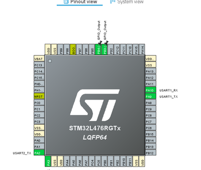

Hi all,
I'm working on a project involving UART communication over RS-485 between an STM32 Nucleo board and a rotary encoder. I'd appreciate any advice or insights on whether my hardware and firmware setup looks correct, and what to check next to ensure reliable communication.
Board: STM32 Nucleo-L476RG
Encoder: 6-pin rotary encoder with the following pinout:
  • Pin 1: 5V
  • Pin 2: B
  • Pin 3: A
  • Pin 4: GND
  • Pin 5: MODE
  • Pin 6: MCLR
RS-485 Transceiver: MAX485-compatible module
  • RO (Receiver Out) → PA10 (USART1_RX)
  • DI (Driver In) → PA9 (USART1_TX)
  • RE (Receiver Enable) → PB3
  • DE (Driver Enable) → PB4
  • VCC: 3.3V (from Nucleo 3.3V)
  • GND: common with Nucleo and encoder
  • A ---> Encoder Pin A
  • B ---> Enocder Pin B
PC Interface:
  • I'm using a USB cable from the laptop to the Nucleo, which powers the board and also uploads code.
  • USART2 is used for debug printouts via USB virtual COM port (seen in PuTTY).
  • USART1 is used for RS-485 communication
I believe my issue is in the software. How do I get communication?
Here are the datasheets:
Encoder: https://www.sameskydevices.com/product/resource/amt21.pdf
Transciever: https://www.ti.com/lit/ds/symlink/sn65hvd11.pdf?HQS=dis-dk-null-digikeymode-dsf-pf-null-wwe&ts=1746316269944&ref_url=https%253A%252F%252Fwww.ti.com%252Fgeneral%252Fdocs%252Fsuppproductinfo.tsp%253FdistId%253D10%2526gotoUrl%253Dhttps%253A%252F%252Fwww.ti.com%252Flit%252Fgpn%252Fsn65hvd11

Welcome @AaravD356, to the community!
At first glance, the hardware configuration looks OK. Do you have termination resistors on both sides of the RS-485 line?
We can only say something about the firmware once you have added at least a few lines of code.
Regards
