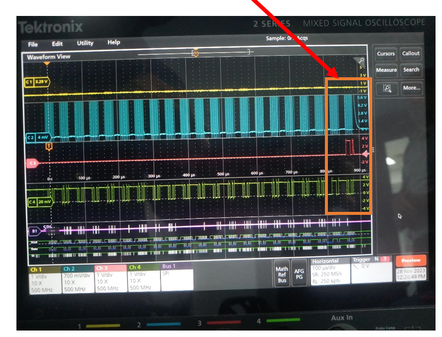

Hard to tell what's going on in your scope plots. Perhaps show transactions with only 4 bytes, per the sync frame requirement.
Note that the ACK procedure requires you to send a dummy byte. If you only send 0xA5, it'll only come back with 0x5A.
AShel.1

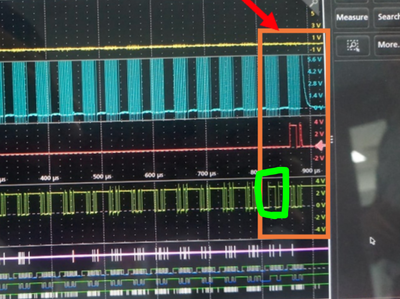

As per the AN4286, master needs to send 0x5A sync byte to initiate the communication and in response slave sends 0xA5 then master needs to keep sending dummy byte 0x00 and read the byte on MISO line this loop will be until slave responds with 0x79 ACK byte. I’m following same sequence for both controllers. In the scope capture named STM32G473_Working.png you can see the 0x79 is received at the end and in STM32G473_NotWorking.png it only sends 0xA5.
Thanks,
In the "working" example, you don't just send 0x5A. The byte circled in green is clearly different.
Regardless, if you only send 0xA5, which is what you say you are doing, the slave will only respond with 0x5A, which is what you say you are seeing. That is the expected behavior.
In your "not working" picture, it looks like the red trace is always 0 so it's only sending 0x00, but you're saying it's sending 0x5A, so maybe I'm missing something.

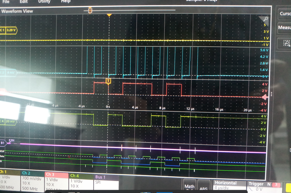

In the working example capture the 0x5A is not seen but I'm sending it, its the same for both controller, here I send 0x5A from H753 on MOSI and Slave sub controller sends 0xA5 on MISO. this sequence is same for both controller and observed same frame on DSO for both controllers.
Yellow-ChipSelect, Blue -Clock, Red-MOSI(0x5A), GREEN-MISO(0xA5)Yellow-ChipSelect, Blue -Clock, Red-MOSI(0x5A), GREEN-MISO(0xA5)
then H753 sends 0x00 as dummy byte and reads MISO line.
on one slave I read 0xA5 for 17 or 18 attempt and then gets 0x79 ACK byte, this ACK is transferred on MOSI as per the diagram mentioned in AN4286
MOSI - 0x00(Dummy), MISO-0xA5 then 0x79MOSI - 0x00(Dummy), MISO-0xA5 then 0x79

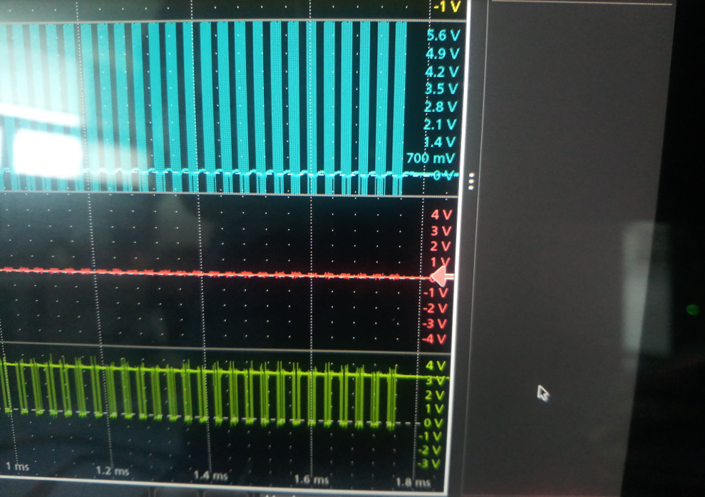

for second controller:  H753 sends 0x00 as dummy byte and reads MISO line, I keep sending the dummy byte as 0x00 and read MISO line, here the data on MISO line is 0xA5, I tried to run the loop for 100, 1000 times but always the data on MISO is 0xA5.
MOSI-0x00(dummy), MISO-0xA5MOSI-0x00(dummy), MISO-0xA5

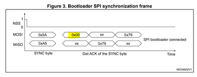

I'm following this sequence from AN4286 Bootloader SPI synchronization frame sequence,

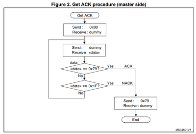

Follow the flowchart in AN4286 to get an ACK. Note that this doesn't say to send 0x00 forever. It's a 3 byte sequence and you read the second byte to determine ACK/NACK.
Send 0x00 dummy 0x79
Receive dummy DATA dummy
Is DATA = 0x79? Then ACK. If 0x1F then NACK. If else, then it's not in the SPI bootloader at all.

I followed the sequence mentioned in Figure 2 of AN4286 also, please note that this sequence is working for one slave.
on this comment:
-- if its not in Bootloader then how come I see 0xA5 on MISO which is mentioned in figure 3 of AN4286.
