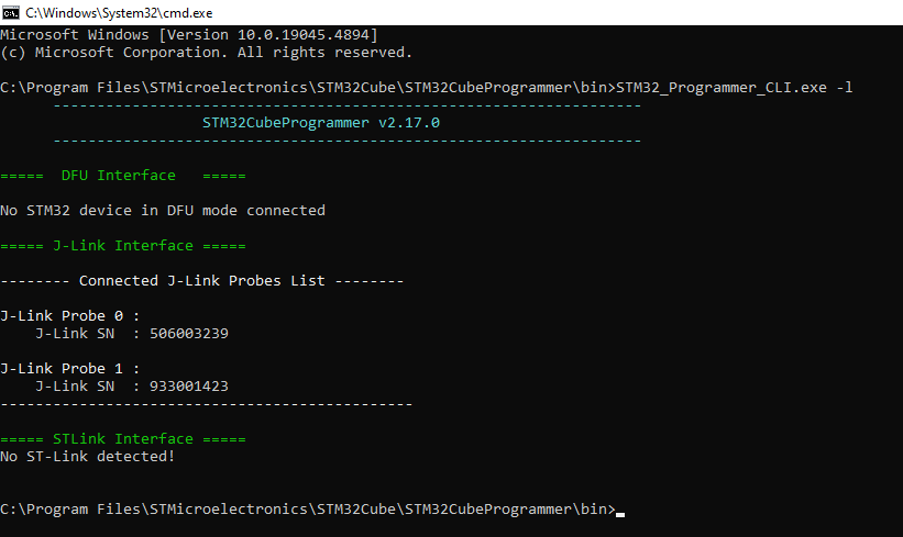

I have been trying to integrate JLINK-SWD, USART, FDCAN and USB DFU interfaces for Open Bootloader for STM32G473 Device, with the STM_Programmer_CLI.exe on Windows (Latest - V2.17.0 64-Bit) and when I prompt to list out the communication interfaces available below are the observations:
1. In case there is no ST-Link Device Connected, there is no listing of the UART Ports. (as show below)
Figure 1 - UART Ports not listed - No ST-Link Connected

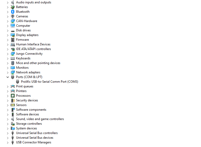

COM3 is detected in Device Manager -
UART COM Port detected on device manager

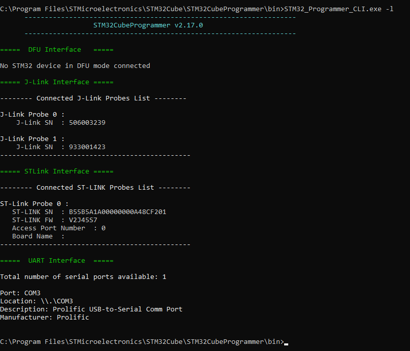

2. In case there is ST-Link Device Connected, then the UART Ports are listed.

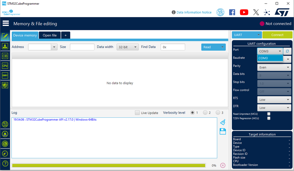

3.This issue is not present in the STM32 Cube Programmer GUI, on refresh the UART Ports update in the GUI Drop-Down.

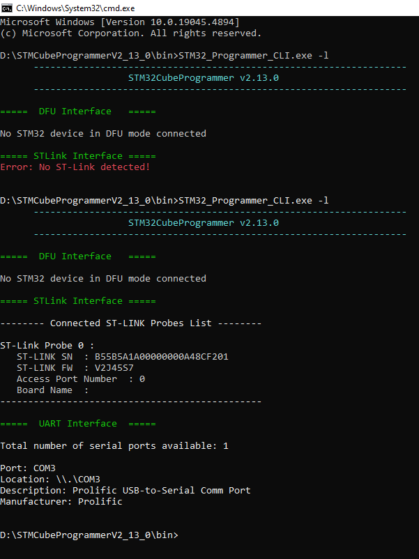

4. With V2.13.0 the issue still persisted same as earlier.
V2.13.0 Log

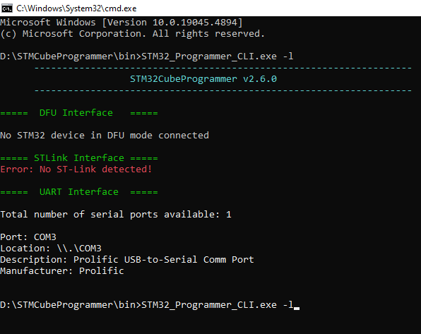

5. In order to verify the issue, installed STM32 Cube Programmer (V2.6.0). And in this version the issue is not present, But since it is an older version I am assuming that the J-Link Interface features are not integrated (J-Link Devices were not listed).
