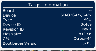

BFB2 Set, but never enter Bank2 program.
Boot0 = 0
Boot1 = 1
I can run the 2 programs from cubeide in there respective locations and ISR work when BFB2 is set for the BANK I am debugging in. However I never enter BANK2 program on resetting/powercycling when BFB2 is set.
Bootloader Version is 0xD5
Does setting this bit somehow need to be utilized at some point or is it just an indicator of what bank we are in
uint32_t mapped = READ_BIT(SYSCFG->MEMRMP, SYSCFG_MEMRMP_FB_MODE);
I never see this high, which may be because I never enter bank2
Stack pointer is set to
_estack = ORIGIN(RAM) + LENGTH(RAM) ; /* end of "SRAM" type memory */
BFB2 Dual Bank Boot does not work as expected. My understanding is this is a valid stack pointer, I have also tried additional stackpointer locations with no luck

Bootloader version is 0xD5, which says no limitations. I have also tried moving the stack pointer per the 0xD4 limitation, still did not work.
My boot pins are set to boot from flash as specified. boot0 is from external pin pulled low, have tried overriding it with the boot options to ensure boot0 = 0 and boot1 =1 and still does not enter bank2 with BFB2
Regardless of BFB2 Being set I am always running from BANK1
RDP is always level 0 : 0xAA
I could give you a sample program but it is just an LED be toggled in BANK1 and then identical program but different LED is toggled in BANK2. Regardless of BFB2 bit being set the internal bootloader only goes to bank 1. I can see it in system memory on restart, but proceeds to bank1
READ_BIT(SYSCFG->MEMRMP, 0x1 << 8);
Lots of people say this is cleared on reset, my understanding is the internal boot loader would set this. this never happens don't know if that's an issue or if thats because internal bootloader never chooses bank2 to jump too.
I have attached an example for STM32G474 modified for STM32G473, that will write a program to bank2 and then set the option bits and launch. Never does it show bank2 active, maybe an issue with that bit or bootloader throws out the program. I want to reiterate I have also done two identical programs with different LED toggling and used STMCubeProgrammer to flash and activate the OptionByte for BFB2 with no success.

LL_SYSCFG_SetFlashBankMode(LL_SYSCFG_BANKMODE_BANK2);
if I manually set this bit at the start of program execution if BFB2 is set then I get the desired behaviour.
is this the expected implementation? seems wrong. I'll have to insert a BFB2 check at the start of program execution and then remap manually myself.
my workaround is calling this prior to anything happening, need to set vector table to 0x08000000 as well
