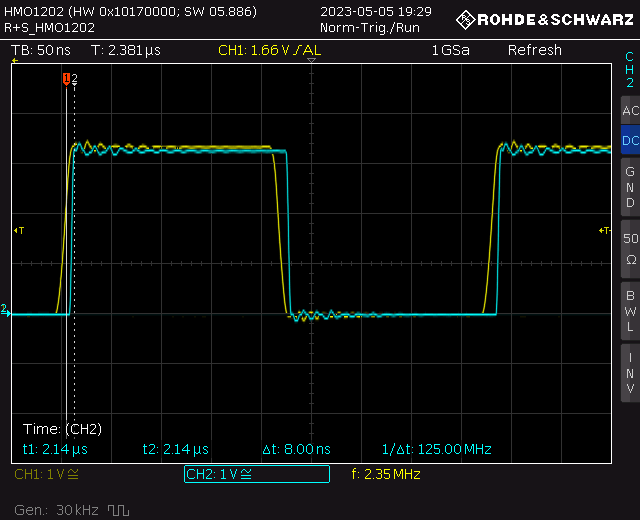

I have 2 PCBs, both with STM32G431 MCUs, and both MCUs should communicate with each other via SPI. Both PCBs are assembled in a chassis, the distance between the two PCBs is aprox. 10 cm. For max. Signal integrity I have chosen to use LVDS as a hardware Layer for the board to board connection. I use Texas Instruments SN65LVDS1 and SN65LVDT2 Drivers/Recievers. Some might consider this as complete overkill, but for me it’s worth the effort.
The LVDS itself works pretty well, as shown in the screenshot below: A signal delay of 8 ns from LVDS Driver IC input to LVDS Receiver Output is IMHO more than good enough for a reliable hardware layer, especially at that slow speed.
Screenshot. SPI Clock signal Master LVDS Driver Input (yellow), Slave LVDS Receiver Output (blue)
