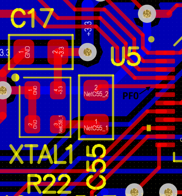

If there are experts here on board tracing, please tell me whether such a board layout can affect the operation of the generator (at a frequency of 40 MHz)? Underestimate its amplitude. Textolite 1.6 mm, red upper layer, blue lower layer. The filling of the polygons of the lower layer is continuous.TCXO routing.png

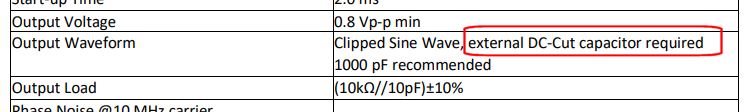

The TCXO datasheet also says:
But Peter has already said that a capacitor link will not work with the STM32.
It sounds like you have selected the wrong part for this application.
Perhaps you should discuss your requirement with Fox and find what they would recommend here:
https://abracon.com/support/tech-support-form
