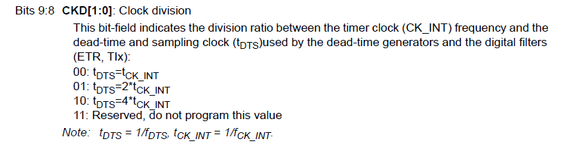

Now, f(dts) is related to the input clock frequency in the Datasheet. The sampling period of this t(dts), can be set to the following settings in the datasheet:
