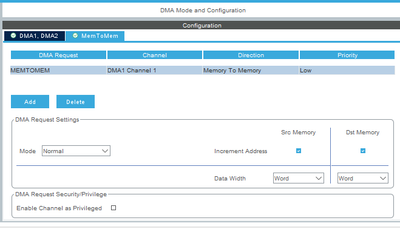

I looked at an example of DMA on CubeMX and I got this code :

It only works once, how to repeat this sending infinitely ?
  /* Configure the source, destination and buffer size DMA fields and Start DMA Channel/Stream transfer */
  /* Enable All the DMA interrupts */
  if (HAL_DMA_Start_IT(&hdma_memtomem_dma1_channel1, (uint32_t)&aSRC_Const_Buffer, (uint32_t)&aDST_Buffer, BUFFER_SIZE) != HAL_OK)
    /* Transfer Error */
    Error_Handler();
Do I have to stop the DMA, recover the data and restart the DMA each time ?

what type of DMA that you use?
Circular?
with address memory increasing?
and You had DMA Callback function too?
This is an example that I took from my STM32L552E-EV evaluation board. It's called DMA. No It's not circular after CubeIDE
After the readme file, it's only a transfer from Flash memory to RAM memory (after me).

if it's no Circular so it's going to stop at the end of address and you have to restart it again as usual.
when you use ADC or SPI with DMA and you set memory with many byte, it's going to stop at the end of address.
you should try with circular mode.
But I'm really unsure what feature do you want. So it may useless for you.
You can either set it to circular mode so it transfers continuously, or you can restart the transfer after the transfer is complete within the TransferComplete callback.
Thank you for this information, to begin with, I would like to understand how DMA works using this example provided.
In fact when I say at the start of my topic, "how to repeat this sending infinitely ?" of course if I use with ADC, I'll have values ​​continually (this sounds a bit like what I'm saying sending the values ​​continuously also requires retrieving the values ​​continuously, right ?).
I know the circular mode, and I have already implemented it with an SAI (by looping the TX with the RX) and it works. But when I enter real values ​​I don't get anything back, that's why I use this DMA example.
With this example I am trying to understand the DMA mechanism. So my question is: How to send and retrieve continuously from this example which only works once ? With the code please no pharses, this will help me move forward.
