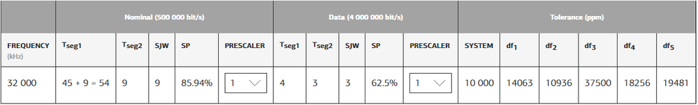

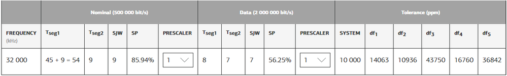

The clock used for FDCAN interface is PLLQ which ticks at 32MHz. The FDCAN parameters were configured using kvaser canfd timing calculator; Filters are disabled.
I’ve generated two set of parameters:
  1. Nominal bitrate 500 kBit/s; Data bitrate: 2MBit/s 0693W00000aHcAbQAK.png
  2. Nominal bitrate 500 kBit/s; Data bitrate: 4MBit/s 0693W00000aHcAqQAK.png

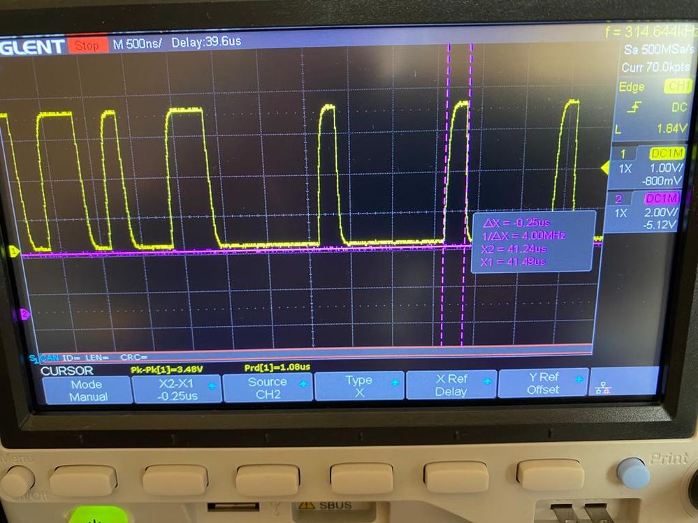

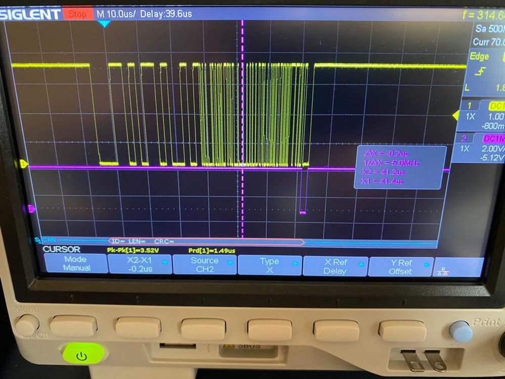

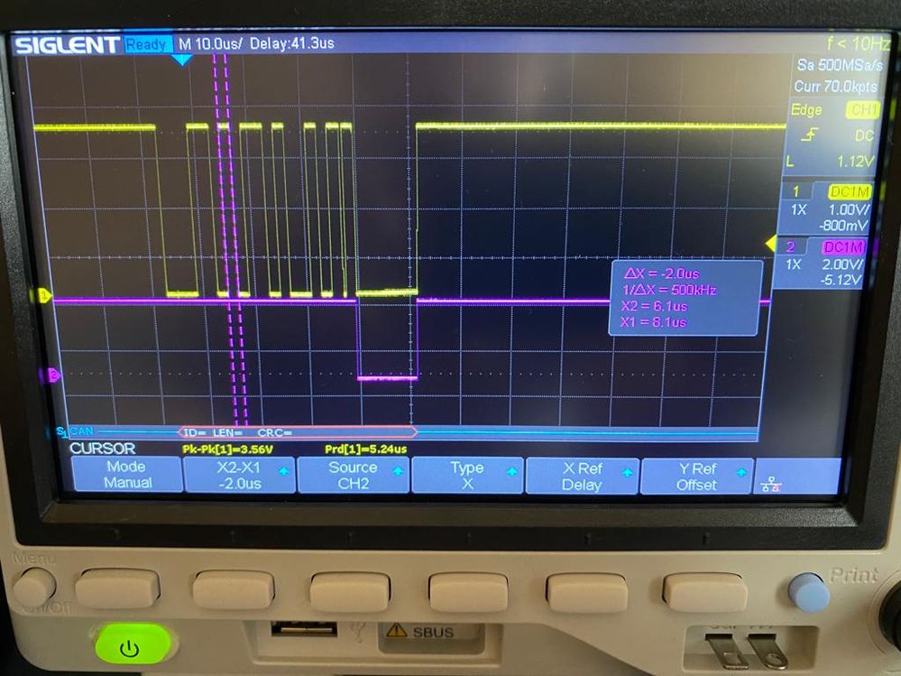

Now, I am facing the following issue. In the first scenario everything works as intended. I receive all the transmitted data.
In the second one (where the bitrate is 4Mbit/s) with the transmitter in normal mode, the receiver node doesn’t receive anything. Switching the transmitter to external loopback, the receiver node receives all the data, as seen in the following images:
4Mbit normal mode
0693W00000aHcC3QAK.jpg4Mbit External loopback mode:0693W00000aHcAmQAK.jpg4Mbit bit timing0693W00000aHcCNQA0.jpgAll of the oscope images are taken on the receiver side on PC4 and PC5 pins.
At 2Mbits everything works as intended. Changing from 2 to 3 or 4 Mbits in normal mode the transmitting board stops transmitting data after arbitration. Switching to external loopback, all the data arrives on the receiver node.
Does someone know what is happening there, why it happens and how can it be solved?
