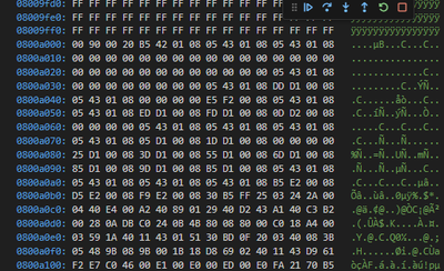

I am developing a bootloader that is currently writing to flash, but I am not being able to jump to the written blocks.
The bootloader runs from 0x8000000. Built with arduino_stm32.
App starts at 0x8009000.
I can test the app with the linker set to 0x8000000 with no problems seen.
So, the bootloader runs, loads the app binary to 0x8009000 and I am not able to jump to it properly.
I think I have done what other developers did in most forum posts.
Added the jump function I am using. After the Jump() call, the PC stops and I can not step the code in asm.

Andreas Bolsch
Lead II
Your jump is to 0x08009004, but that's the location of the reset vector, so you're missing one level of indirection. The jump target is the *contents* of 0x08009004.

So I changed the app address and the code:
// build_flags = -DUSER_APP_ADDRESS=0x0800A000
void BootJump(void) {
    void (*Jump)(void);
    HAL_RCC_DeInit();
    HAL_DeInit();
    SysTick->CTRL = 0;
    SysTick->LOAD = 0;
    SysTick->VAL  = 0;
    Jump = (void (*)(void)) (*((__IO uint32_t *)(USER_APP_ADDRESS+4)));
    SCB->VTOR = (uint32_t)USER_APP_ADDRESS;
    __set_MSP(*(__IO uint32_t*)USER_APP_ADDRESS);
    Jump();
App linker changed to:
/* Memories definition */
MEMORY
  RAM    (xrw)   : ORIGIN = 0x20000000, LENGTH = LD_MAX_DATA_SIZE
  FLASH  (rx)    : ORIGIN = 0x800A000, LENGTH = LD_MAX_SIZE - 0xA000 - 2048
App build flags:
-DVECT_TAB_BASE_ADDRESS=0x08000000
-DVECT_TAB_OFFSET=0xA000
The app seems to be correct in flash.
After the jump, the PC is stuck at 0x08014304
Looks like it has crashed, but platformio does not show the disassembly for this section.
