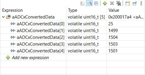

I configured ADC with DMA for 5 channels.
but converted values are wrong. Last channel value stored in First in the buffer and
First channel value copied to remaining buffer

what could be wrong ? Value 25 should be in Last value in the buffer.
third to fifth values are copied from second channel.
When I configure only one channel then Conversion is ok.

found problem in Rank assignment.
corrected as given below. It is working fine. used separate Rank for each channel.
but HAL generated code above. dont know why.
