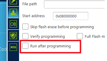

I have a custom board and application using the mentioned MCU, when I use the "run" with the Release option  on STM32CubeIDE and once I use the board alone the FW starts flawless as soon I power up. Now when I use the STM32CumeProgrammer to upload the "Release" bin file the board do not start the FW after powering up the board but need to press reset for it to start. These behavior tells me is not an issues with the NRST's RC circuit. Could anyone help me to solve this issue, cause have a production waiting to solve this issue since all the boards were programmed using the  STM32CumeProgrammer for speed in production and now all of them need to use the reset button to start.
Al OB are as suggested in the forums and documentation nBOOT_SEL=1, nBOOT0=1, nBOOT1=1
Thank you in advance.

When the device fails to start, attach a debug session to it without downloading or flashing the chip to see where execution is at.
If device was erased prior to the flash, you will need to load option bytes to clear the empty check flag. Resetting does this. See "2.5.4 Empty check" in the reference manual.
mƎALLEm
Did you check the option "Run after programming"?:
