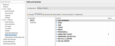

Hi @Franz.1
Could you please check in predefined symbols are activated?
_TRACE
_GUI_INTERFACE
Best regards,
FBL
Franz.1
Hi @FBL ,
Yes, it seems they are (see screenshot below from CubeIDE)
Am I right that your answer suggests that the Messages exposed in the GUI should be already handled by the Example/Demo Firmware as setup in the mentioned tutorial?
Thanks!
//Edit: I was not sure whether with “activated” you mean “just defined” as they are in the screenshot or also set to a value like “1”? But I tried both, did not make a difference.
//EDIT2: At least (by scope) I can tell there is data on both the RX and TX lines of the LPUART when I try to send a Message from GUI to the board and the board seems to answer... generally the MonitorTool and/or stack seems incredibly unstable. I can as I said issue no messages beside of Soft Reset and hard Reset . Sometimes, but only sometimes and as a first action after board reset the "Get Status" Message at least blinks "green" in the Gui, but even then this only works once until I reset the board again. All other Messages are broken "all the time".
