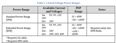

You cannot select 12V in regular fixed voltage power ranges, simply because it's not authorized in this category.
Check the PD spec :

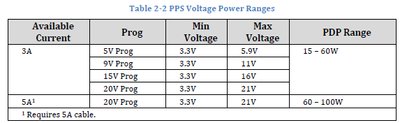

If you want to select 12V, you may use the PPS PDO type :
Regards,
