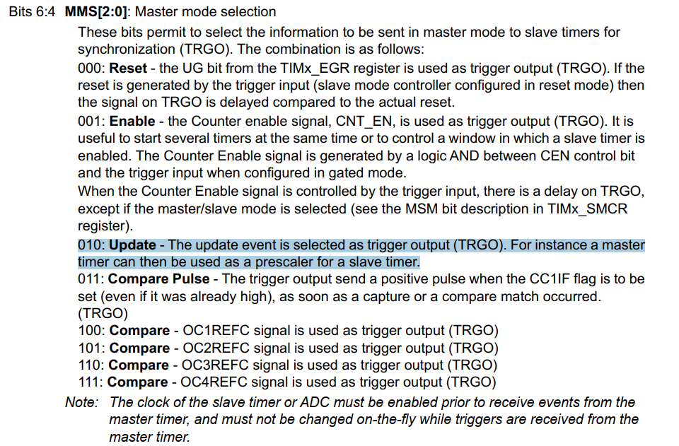

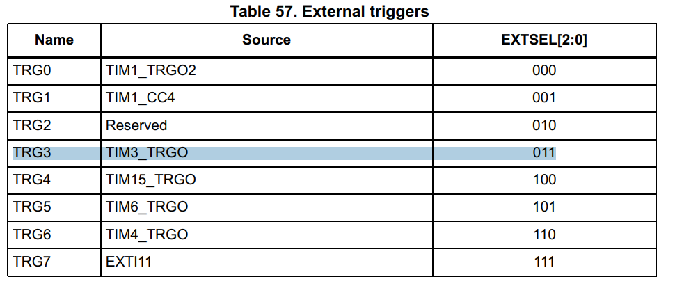

STM32G0 series TIM+ADC+DMA. Why does an external event not come from the timer?
  • November 25, 2022
  • 4 replies
  • 1856 views
I have had an experience of working with TIM+ADC+DMA on microcontrollers F series. Now I need to use TIM+ADC+DMA on microcontroller STM32G030F6P6. A part of ADC and DMA registers was changed in G0 series. I want to digitize sequencely two channels after external event and get result with DMA. I wrote a code for working with TIM+ADC+DMA on STM32G030F6P6:

	ADC1->CFGR1 |= (1 << ADC_CFGR1_EXTEN_Pos); //01: Hardware trigger detection on the rising edge
	ADC1->CFGR1 |= (3 << ADC_CFGR1_EXTSEL_Pos); //TIM3_TRGO

	TIM3->CR2 = (2 << TIM_CR2_MMS_Pos); //010: Update - The update event is selected as trigger output (TRGO)
	TIM3->PSC = 1600-1;
	TIM3->ARR = 1000-1;
	TIM3->EGR |= TIM_EGR_UG;
	TIM3->SR &= ~ TIM_SR_UIF;
	TIM3->CR1 |= TIM_CR1_CEN;
It doesn't work. I noticed that external event which should start ADC doesn't come from timer. If I manually start ADC (ADC1->CR |= ADC_CR_ADSTART) then I get result. Why does an external event not start ADC?
I went over the documentation several times, tried various options, but could not start TIM + ADC + DMA on STM32G030F6P6. I was already desperate and decided maybe someone could help me here ...

  • are you sure of
does what you want ?
  • are you sure of
doing what you want?

are you sure of
are you sure of

What if
is overwriting some other important stuff in CR2?
Im seeing now you dont use any
to set those bits
Or maybe youre trying to set the MMS in the wrong register, i dont really know, just trying to get some clues
