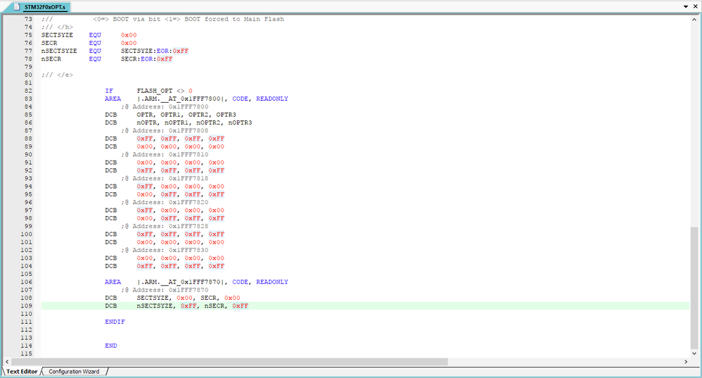

I'm trying for the first time the new STM32G071RBT6, I'm looking to set the correct option byte via the .s file but something is wrong..

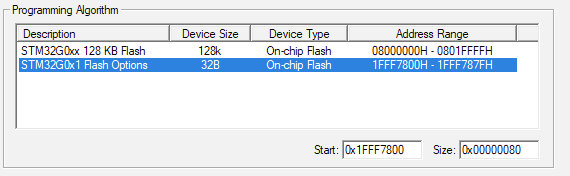

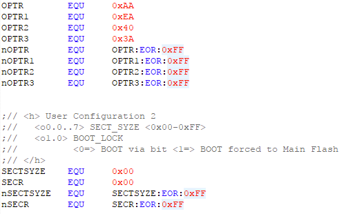

I want to set 0x3A40EAAA in address 0x1FFF7800, and all zero in address 0x1FFF7870 (because BOOT_LOCK is set by default).
I see that the first 32bit+32bit complemented are flashed, but the other are not flashed..
