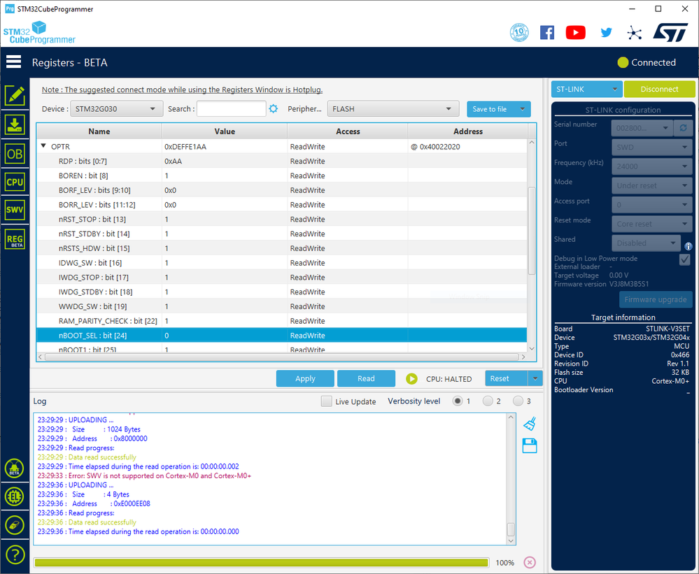

I work on the stm32g0 micro.
i programmed it with a simple "blinky" code.
it works correctly.but when i reset it doesn't work until i program it again.

I bought a standard test board, and tested with it, the problem still exists.

The same problem for me and the year is almost gone. When ST pretend to solve this problem?
‎2021-11-22 8:32 PM
Ok, I got a workaround, changing bit nboot_sel from 1 to 0 fix the problem of bad reset while debugging.
‎2021-11-22 9:18 PM
This is because G0 goes down to small pincount packages, hence Reset can be gpio, boot pin is also swd signal for debug.
