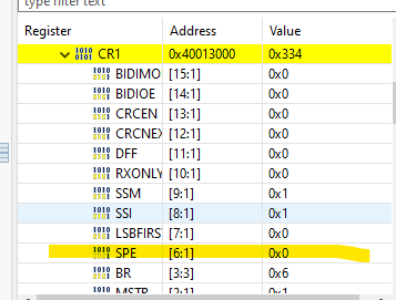

I am trying to interface eeprom module with STM32F0308-Disco board using CUBE IDE - HAL library. SPI communication is not working properly, I am getting random values while trying to read the Eeprom ID.
While debugging the code I found that the SPE bit in CR1 register is not set to 1 even after initialization. What could be the issue?
Attaching the code below.
Cube is open source, so you can check what HAL_SPI_Init() does. Indeed, it does not enable SPI; the idea is, that it's enabled only when some of the "communication" (HAL_SPI_TransmitXXX()) functions are called.
To reveal what's the problem, observe MISO/MOSI/SCK lines using oscilloscope/logic analyzer.

That's just how the library works.
You can send a zero-length message which has the effect of enabling the peripheral which sets the clock polarity correctly.
HAL_SPI_Transmit(&hspi1, 0, 0, 0);

The issue was resolved, I was reading two bytes using the HAL_SPI_Receive which should be 1 byte in my case. As @Community member​ said the SPI is enabled only during the Transmit or receive function is called.
Thank you @Community member​ and @TDK​
