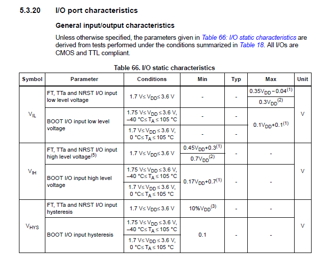

I am using STM32F777, can you please help where i will get VIH voltage level for SPI Ports in datasheet?

For better understanding, I have attached Snapshot form STM32F777 Datasheet.
Also please confirm it is applicable for SPI Channel as well.
In my Case, I have VDD:3.3V
So VIH=(0.45*VDD+0.3)/(0.7*VDD)=(0.45*3.3+0.3)/(0.7*3.3)=0.77V
is it right? Please confirm

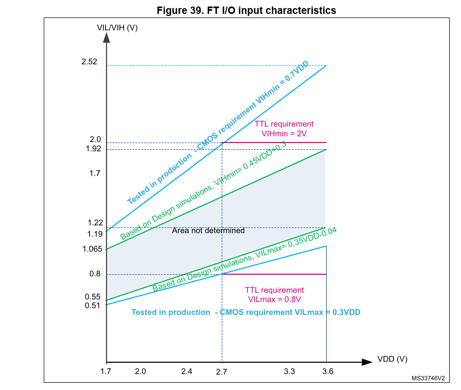

AScha.3
nooo....no division !
tested is : 0,7 * Vdd -> 2,31 V min.
0693W00000VOQ4fQAH.pnghere you see : tested 2,3V ; may switch from 1,7V up (green line).
and SPI is same other port pins , ok?
