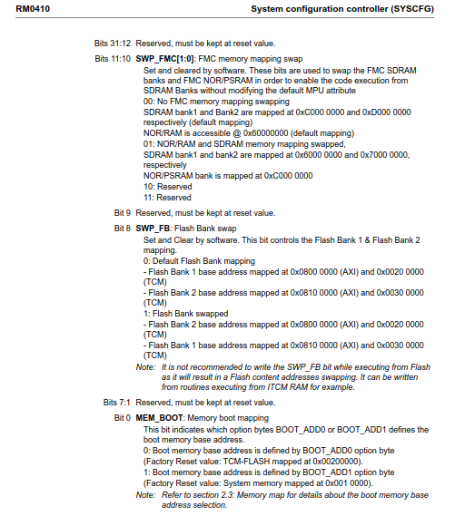

And then I want to remap the SYSCFG memory remap register (SYSCFG_MEMRMP)
but there is no option to do at STM32F7xxxx :pouting_face:
This is the SYSCFG_MEMRMP
Why setting the Vector Table Offset Register is not enough and I have to remap hardware?
Why the SRAM remap option of STM32F4xxxx (see RM401 7.2.1) was removed at STM32F7xxx ?

1 REPLY 1
ITCMRAM is AT ZERO, you don't need to remap it. Both ITCM and DTCM RAM should permit instruction reads
The SCB->VTOR pointing to zero should point to the ITCMRAM, and functionality should be demonstrable.
