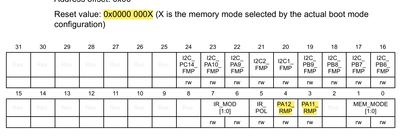

If I understood the specsheet correctly ("Pins PA9 and PA10 can be remapped in place of pins PA11 and PA12 (default mapping), using SYSCFG_CFGR1 register"), PA12/PA11 are default (and not PA10/PA9), so a fresh chip out of the box can be used for USB DFU, am I correct in this assumption?

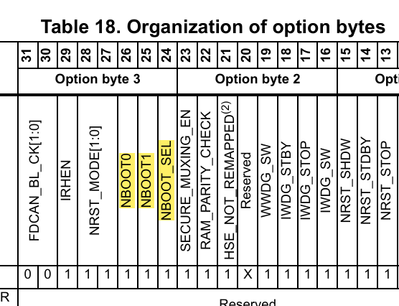

Then there is my next question - how does BOOT0 work? If I understand correctly, the boot selector bits decide whether PA14 is BOOT0, or whether a software bit is used. The patterns in AN2606 are as follows:
What I do not understand - how are the defaults? As in, if I have a fresh chip directly from the factory, how is it set up? Will PA14 operate as BOOT0 out of the box, or is this something I have to manually set in a first-time-flash? If the flash memory is empty the chip should always default to entering the bootloader, so I can flash a firmware that sets the correct bits through USB, and from there on PA14 is BOOT0, correct? I am sorry for asking questions that may seem trivial - bootloader patterns have been confusing me before, and I would prefer a prototype that works at least well enough to test all important features. This is a personal project, so prototyping funds are limited.

PA11/PA12 are used until you remap them. This has to be done after powerup--it is a volatile setting.
PA14/BOOT0
Default option bytes are nBOOT0 = nBOOT1 = nBOOT_SEL = 1. But since the flash is empty, the USB bootloader will load the first time it's powered (third pattern in the table).

‎2025-01-26 12:20 PM
First of all - sorry for the late reply. I was busy and had my head elsewhere so forgot to get back at you.
Thank you very much for your help! I overlooked the reference manual when I checked, and thought it might still be unreleased. Now that you told me it exists I went back and found it. You helped me out with all the questions I had.
So summing it up - A11/A12 will be default, and entering USB DFU out of the box is no problem. Then I can set nBoot_Sel to 0 at the first flash, and from that point on pulling boot0 high at boot will enter bootloader, and once the chip boots into program memory PA14 is available as a regular GPIO.
