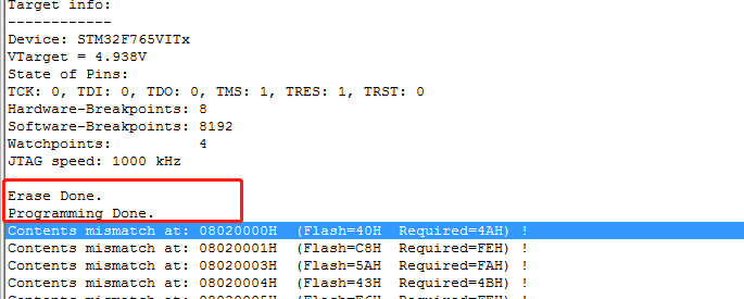

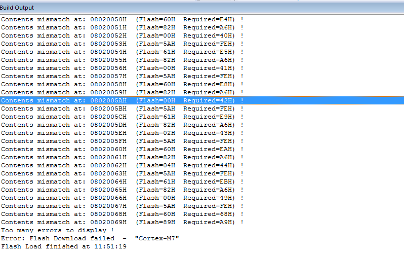

STM32F765VIT6 code compiled with KEIL MDK5.26.2.0 tool and verified error when downloading firmware with J-Link V9
JLee.0
"error:flash download failed - cortex-M7"

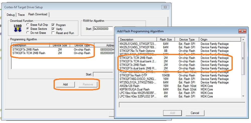

Ok, so you probably want to go into the debugger/flash settings and pick a different flash algorithm. ie banked vs non-banked.

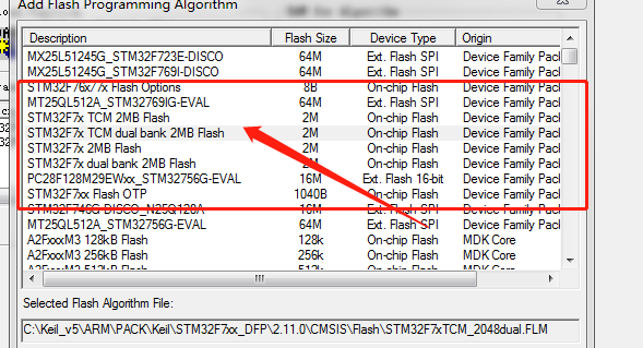

for my ​STM32F765VIT6:
if my flash option bytes select ​single banked,what can i pick a flash algorithm?
if ​if my flash option bytes select ​dual banked,what can i pick a flash algorithm another?

The error you are reporting is indicative of a mismatch in the banking vs flash algorithm.
So if you currently have the single bank ones selected, Remove them, and then Add the dual bank versions. Or the other way round depending on what isn't working currently. And the observe if it works then, or not.
If you still have a problem there may be other issues, but let's cross that bridge later if necessary.
