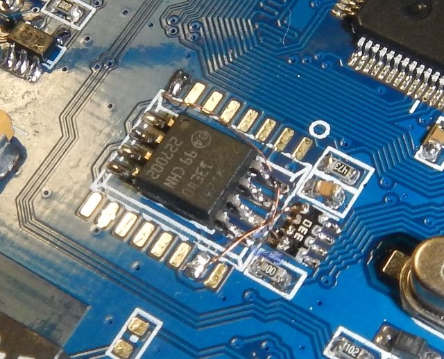

‎2017-03-12 10:55 AM
reporting: alternative pinout just works, tested with u-boot sf susbsystem (on full 108 MHz speed, erase, read, write, everything)
(I've made mistake on this board - accidentally swapped IO0/IO1 pins so it needed some small rework as you can see)
