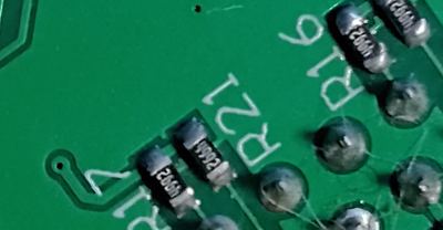

I have designed an ethernet interface  for an F746-100 MCU
I have changed pins to avoid using Port G and I have used the  circuit below.
The RJ45 connector is a standard RB1-125BAG1A and the ethernet chip is a LAN8742A
Can anyone tell me if there are any mistakes in this?
I cannot get any connection at all - F746-100 will not ping.
Green LED ON and Yellow LED flashes continuously.
I have an STM32F746 - 144 Nucleo with the same software (apart from the two pins that are changed) -works fine.
The 25MHz xtal works OK (same signal on both boards) and the LAN8742_STATUS_OK returns 0  on both boards when I debug.
There appears to be no errors in the setup LAN8742.c or the ethernetif.c when I debug. This code works OK on the NUCLEO board and I can display a small webpage. Both sets of code use only ETH and LWIP, fixed IP, on a standard Cubeide setup. I assume that the only difference is the two GPIO allocations (PG13>PB12 and PG11>PB11) which I have altered in software.
I have the same sort of signals on both boards on TXP/TXN/RXP/RXN
Can some kind soul tell me if there is anything obviously wrong with my hardware?

JOY of JOYS!!!
A *** mistake -
4 resistors on Ethernet circuitry were incorrect.
I am not too familiar with SMD markings, and I wrongly assumed '4992' was 49.9 ohms, when in fact they are 49.9Kohms.
It was not possible to measure them on the board since they were across a coil.
I replaced them with 4 standard resistors and ethernet works OK!
Thank you all so much for helping me.
The circuit and the project I uploaded are guaranteed to work, so hopefully this will help others.

STea
Hello @clock.1166 ,
Implementing the Ethernet on custom board can be a challenging task and i will try to help you to get over this problem .
first i need some clarification with previous conversation with @STOne-32 .
  1. "The 25MHz xtal works OK (same signal on both boards) and the LAN8742_STATUS_OK returns 0  on both boards when I debug." how did you make sure that the Xtal 25 Mhz is outputting the same signal on both boards i ask you this because issue with the precision of the clock source can lead the application to malfunction.and the jitter can affect the Ethernet periph behavior.
  2.  is the gpio speed for all the assigned pins is put to very high this is also the recommended setting for the Ethernet ?
adding on that i have to ask you some further questions to verify the root cause of this problem:
  1. verify if there is a change in the VDD level between the two boards .
  2. check if you can visualize the signals from the TXD0 and TXD1 to see if there is traffic between the MCU and the LAN8742A
  3. try to read the status of  LAN8742A with the help of the init function api in LAN8742.c in run mode (toggle an LED when LAN8742_STATUS_OK returns 0 )
  4. the RST pin in your design seems to be not connected can you give more info on it its not clear in the picture
  5. can you give us information about the clock source feed to the MCU .
hope you will get back to me with some good news or helpful information to get it working soon.

LCE
Principal II
25.1 MHz - that on the board that is not working?
50 MHz clock is generated by the PHY?
After your GPIO switch - checked all the alternate function numbers?
PCB layout: around the crystal and clocks all clean? No crazy routing of the high speed signals?
PHY: Read all the registers and check / compare to datasheet.
