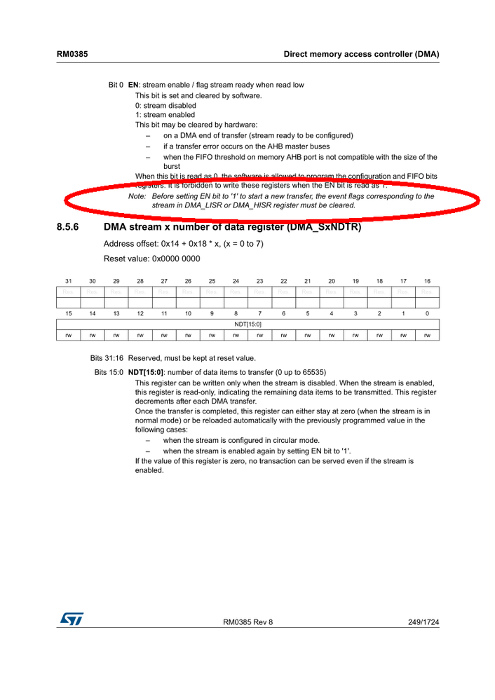

So right now, I AM receiving the first 11-byte transaction from the SPI slave (great!) - I DO see my_data[11] update with correct values. After this, when a second transaction is sent, my data buffer (my_data[11]) does not change, even though the SPI1 registers do change. This tells me that the SPI is still receiving data, but the DMA itself isn't transferring it.
I'm not using interrupts for this (at least not yet). I also see that my DMA2 -> S1NDTR changed from 11 to 0 after the first transaction. When I change this back to 11 using the debugger, it still does not perform additional DMA transactions.
--> I believe I'm not "resetting" the DMA properly, after a transaction has been performed.
Try resetting the DMA interrupt flags (LISR or HISR)
waclawek.jan
... using LIFCR/HIFCR.
Richard Tarbell_2
Thank you for your help again! OKAY, I have reset the DMA interrupt flags by writing "1"s to the appropriate LIFCR register positions.
--> When I call HAL_DMA_Start() the first time at code startup, everything works, and my return status is HAL_OK.
--> After my first DMA transaction, I clear the DMA interrupt flags, and I call HAL_DMA_Start() again. This time, it returns HAL_BUSY, so the stream never enables again. Should I keep calling HAL_DMA_Start() until I get a HAL_OK status?
