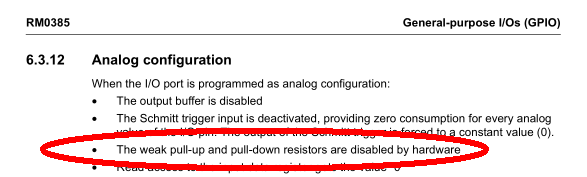

I am trying to read the ADC value from PA0 pin on a STM32F7 Disco board but without any success.
The issue is that the ADC reading is acting as the pin is floating
I suspect that the initialization code is not correct due to the fact that if i change the the Pull parameter to PULLUP/DOWN the behavior of the ADC value stays the same.
I have try to run also the example ADC_RegularConversion_DMA from STM32Cube_FW_F7_V1.7.0 but the behavior of the value is the same (i run the code on 2 different new boards)
I have attached the ADC code for review.
Can someone help me figure it out what is wrong here?
Thanks

  sConfig.SamplingTime = ADC_SAMPLETIME_3CYCLES;
Perhaps the ADC input is actually 'floating'.
What are your timing requirements and attached analog input hardware (impedance) ?

IMO 5V-tolerant pins disconnect pullup/pulldown when switched to analog mode.

Perhaps I was a little cryptic.
I meant, 3 cycles is a
very
short sample time. If there is no adequate analog input driver, the value seems to float ...

It has nothing to do with pull-up/pull-down configuration. It rather sounds like a deeper understanding of a SA-ADC is missing.
