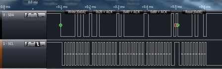

Hello!
I need to connect two STM32F407Discovery board via i2c for my task. First board is master which send data packet to slave board and receive data back. Slave board just receive data and save it for master. Next part works correct, slave send ack to master; led is blinking.

When I try to receive data from slave:
uint8_t received_data[2];
while
(1)
I2C_start(I2C1, SLAVE_ADDRESS, I2C_Direction_Transmitter);
I2C_write(I2C1, 0x20);
I2C_write(I2C1, 0x40);
I2C_write(I2C1, 0x80);
I2C_stop(I2C1);
I2C_start(I2C1, SLAVE_ADDRESS, I2C_Direction_Receiver);
received_data[0] = I2C_read_ack(I2C1);
received_data[1] = I2C_read_nack(I2C1);
I2C_stop(I2C1);
LED_GREEN_TOGGLE;
_delay_ms(50);
my program is freezing on line:
I2C_start(I2C1, SLAVE_ADDRESS, I2C_Direction_Receiver); ,
Led isn't blinking. Code for slave board:

Image from logic analyzer: 0690X00000602zPQAQ.jpg Also are attached source projects in CooCox IDE 1.7.6 Can anyone share working code for I2C slave (it doesn't matter with interrupt or without it) Thanks. #i2c #stm32f4discovery #slave
